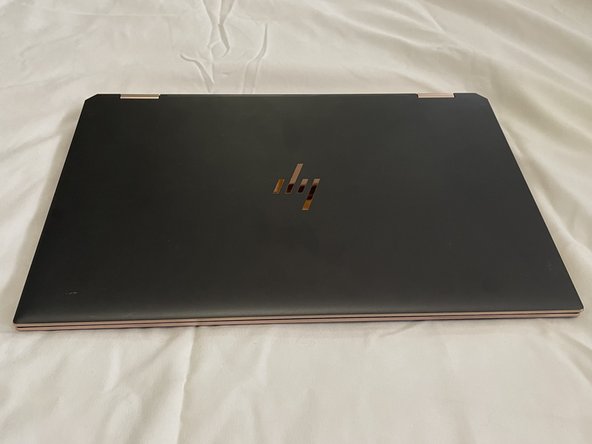

    • Make sure that your laptop is powered off and that no device is plugged into it.
    • Carefully flip the laptop over, with the bottom side facing up.
    • Ensure the laptop hinges are furthest away from you for better access in the following steps.
