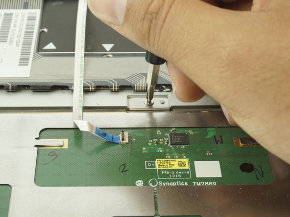

  6. HP Spectre 13 4003dx x360 Touchpad Replacement: step 6, image 1 of 3 HP Spectre 13 4003dx x360 Touchpad Replacement: step 6, image 2 of 3 HP Spectre 13 4003dx x360 Touchpad Replacement: step 6, image 3 of 3
    • Using the PH00 Screwdriver, remove the five 2.0 mm screws indicated in the picture.
