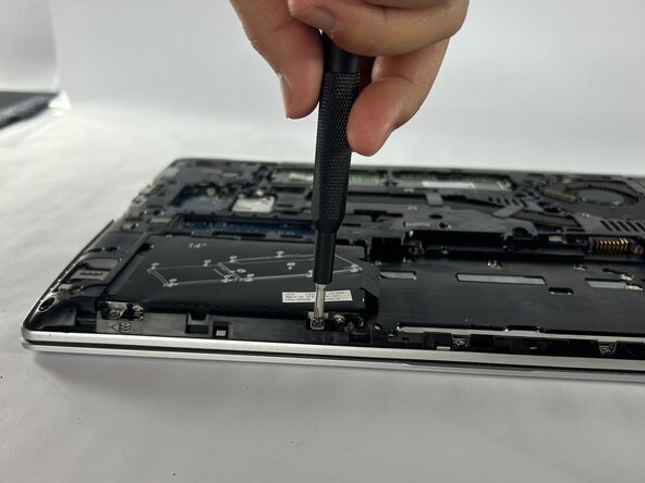

    1. HP ProBook 640 G4 SSD Replacement, SSD: step 4, image 1 of 3 HP ProBook 640 G4 SSD Replacement, SSD: step 4, image 2 of 3 HP ProBook 640 G4 SSD Replacement, SSD: step 4, image 3 of 3
      • Loosen the four captive 2.5 mm-long Phillips screws securing the SSD.
      • Captive screws cannot be removed.
      • Grip the SSD and slide it out while lifting up.
