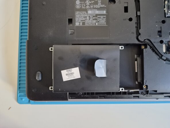

    2. HP ProBook 470 G0 thermal paste Replacement, DVD drive and hard disk removal: step 2, image 1 of 3 HP ProBook 470 G0 thermal paste Replacement, DVD drive and hard disk removal: step 2, image 2 of 3 HP ProBook 470 G0 thermal paste Replacement, DVD drive and hard disk removal: step 2, image 3 of 3
      • Unscrew the four screws of the hard drive or ssd as well as the DVD drive.
      • Slide the DVD drive out of the case which will expose two screws we will have to take care of soon.
      • Slide the hard disk or ssd away from the connector and lift it out of the case.

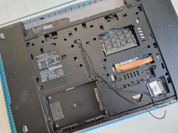

    3. HP ProBook 470 G0 thermal paste Replacement, Unplug the wifi card: step 3, image 1 of 3 HP ProBook 470 G0 thermal paste Replacement, Unplug the wifi card: step 3, image 2 of 3 HP ProBook 470 G0 thermal paste Replacement, Unplug the wifi card: step 3, image 3 of 3
      • Locate the wifi card in the lower right of the case next to the BIOS battery.
      • Lift off the brass connectors carefully using your fingernails, a spudger or jimmy knife.
      • The wifi card may stay in place as you do not have to remove it from the motherboard to remove the motherboard itself.

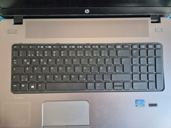

    4. HP ProBook 470 G0 thermal paste Replacement, Remove the keyboard: step 4, image 1 of 3 HP ProBook 470 G0 thermal paste Replacement, Remove the keyboard: step 4, image 2 of 3 HP ProBook 470 G0 thermal paste Replacement, Remove the keyboard: step 4, image 3 of 3
      • On the back you will find two screw holes with a keyboard symbol which have to be removed.
      • Turn the notebook around, open the display and find that the keyboard can now be wiggled around. Pull it down a bit and use a spudger to lift it out.
      • Be careful not just to rip it out as it is still connected by a large ribbon connector.

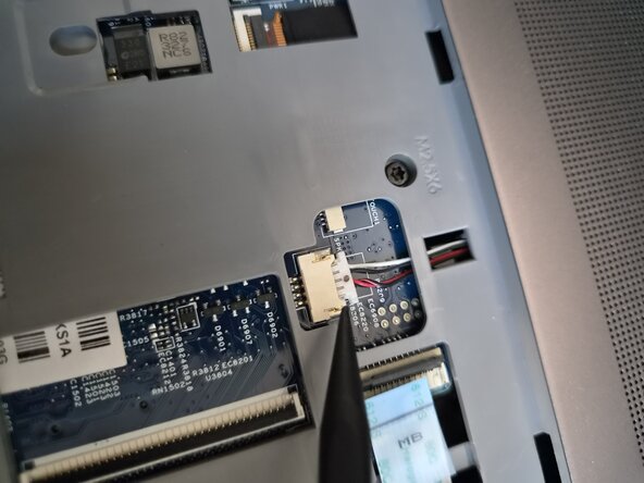

    5. HP ProBook 470 G0 thermal paste Replacement, Unplug the ribbon cables: step 5, image 1 of 3 HP ProBook 470 G0 thermal paste Replacement, Unplug the ribbon cables: step 5, image 2 of 3 HP ProBook 470 G0 thermal paste Replacement, Unplug the ribbon cables: step 5, image 3 of 3
      • You will have to unplug several ribbon cables on the side now. This is fairly easy - look for the black lever on each connector and lift it up carefully using a spudger or your fingernails.
      • Remove the large keyboard ribbon cable if not already done and then proceed with the other marked connectors.
      • Make sure all ribbons are disconnected by placing them on top of their connectors.

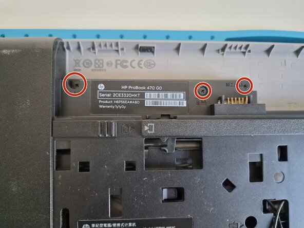

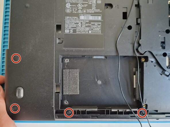

    7. HP ProBook 470 G0 thermal paste Replacement, Screw removal part 1: step 7, image 1 of 3 HP ProBook 470 G0 thermal paste Replacement, Screw removal part 1: step 7, image 2 of 3 HP ProBook 470 G0 thermal paste Replacement, Screw removal part 1: step 7, image 3 of 3
      • Close the screen lid and turn the notebook on its back again.
      • Now you will have to remove copious amounts of screws on the back.
      • Do not forget the screws which are hard to locate in the battery compartment.

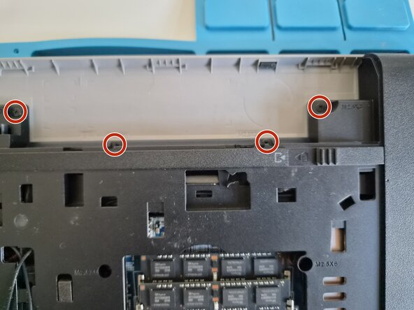

    9. HP ProBook 470 G0 thermal paste Replacement, screw removal part 3: step 9, image 1 of 2 HP ProBook 470 G0 thermal paste Replacement, screw removal part 3: step 9, image 2 of 2
      • Remember the two screws under the dvd drive? Now is the chance to remove them.
      • The red circles show the location of the outer case screws you will have to remove.

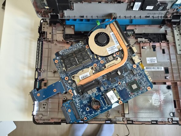

    13. HP ProBook 470 G0 thermal paste Replacement, Success - the board is out!: step 13, image 1 of 2 HP ProBook 470 G0 thermal paste Replacement, Success - the board is out!: step 13, image 2 of 2
      • With all connectors and screws removed you may pull the motherboard to the right.
      • Make sure not to bend the heat pipe and stop and investigate before applying too much force!
      • Look at all the screws we gathered. Its probably best to use a magnetic mat and align the screws as you found them in the ProBook.

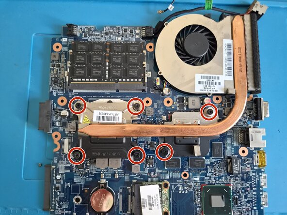

    14. HP ProBook 470 G0 thermal paste Replacement, Heatsink removal and finish: step 14, image 1 of 3 HP ProBook 470 G0 thermal paste Replacement, Heatsink removal and finish: step 14, image 2 of 3 HP ProBook 470 G0 thermal paste Replacement, Heatsink removal and finish: step 14, image 3 of 3
      • Place the board somewhere safe and remove six screws from the heat pipe.
      • It is best to unscrew cross-wise (top left, bottom right, bottom left, top right) especially when putting the board together because the DIE of the GPU and CPU are exposed, not protected by a heat spreader and could easily crack when applying too much force on one side.
      • Clean up the old thermal compound on the GPU and CPU as well as the heat sink with rubbing alcohol.
      • If your fan is clogged with dust now is the time to clean it up as well.
