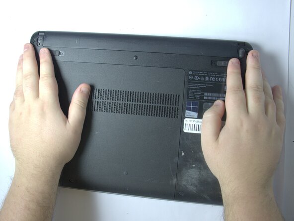

This guide will show you how to replace your memory modules. If your computer is running slow, crashing, or corrupting files inexplicably, you may need to replace your RAM/Memory Modules. The following steps will guide you in making the replacement yourself.
Tools
    1. HP ProBook 430 G3 RAM Replacement, Battery: step 1, image 1 of 1
      • Position the laptop upside down.
