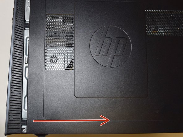

    2. HP Pavilion Model H8-1202 RAM Replacement, Opening case: step 2, image 1 of 2 HP Pavilion Model H8-1202 RAM Replacement, Opening case: step 2, image 2 of 2
      • Safely place the computer down on its side and slide the panel off the case.
      Ask FixBot

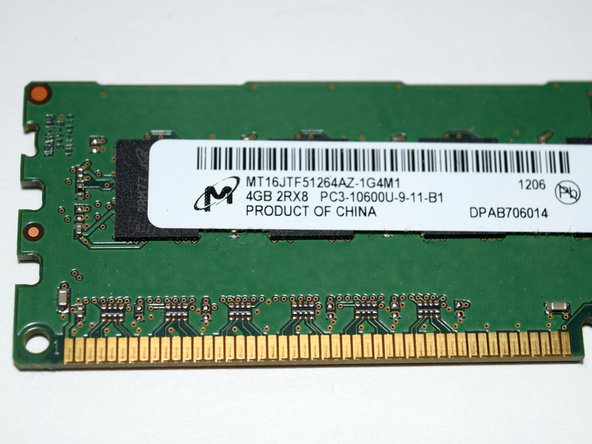

    6. HP Pavilion Model H8-1202 RAM Replacement, Replacing RAM: step 6, image 1 of 1
      • Set aside used RAM sticks and replace them with new RAM sticks. Push clips back in to secure new RAM sticks.
      • RAM sticks should audibly "snap" into place if placed correctly.
