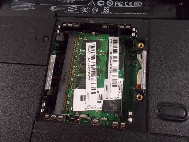

      • Lift up on the RAM cover and remove it to reveal RAM sticks.
      Ask FixBot
    4. HP Pavilion G60-247CL RAM Replacement: step 5, image 1 of 2 HP Pavilion G60-247CL RAM Replacement: step 5, image 2 of 2
      • Gently pull apart the two metal tabs located on both sides of the stick of RAM.
      Ask FixBot
    5. HP Pavilion G60-247CL RAM Replacement: step 6, image 1 of 1
      • Gently lift the RAM stick up and out of its seat.
      Ask FixBot
    6. HP Pavilion G60-247CL RAM Replacement: step 7, image 1 of 1
      • Repeat the previous two steps for the remaining stick of RAM.
