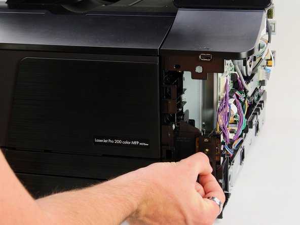

  4. HP Laserjet Pro 200 Color MFP Power Button Replacement: step 4, image 1 of 2 HP Laserjet Pro 200 Color MFP Power Button Replacement: step 4, image 2 of 2
    • Turn the printer so that you are facing the open side with the power button chord.
    • Carefully remove this cord.

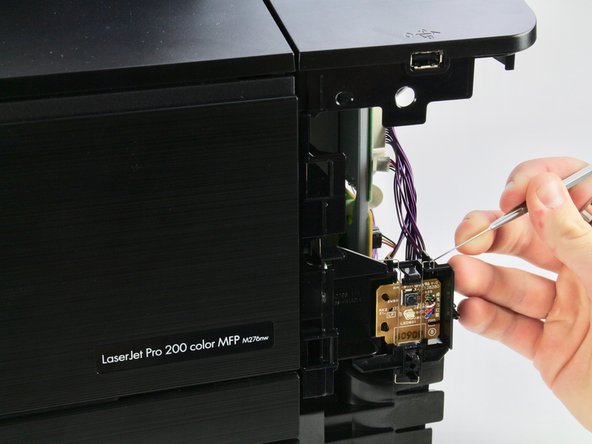

  6. HP Laserjet Pro 200 Color MFP Power Button Replacement: step 6, image 1 of 1
    • A tension spring in the form of a bent wire is used to hold the assembly in the printer.
    • In order to remove the spring completely, begin by removing the right end of the wire from it's slot above the power button with a metal spudger.
  7. HP Laserjet Pro 200 Color MFP Power Button Replacement: step 7, image 1 of 1
    • Unclip the left side of the wire from printer by applying upwards pressure along the edge of the wire.
    • This step can be done with either your fingers or a prying tool of your choosing.
