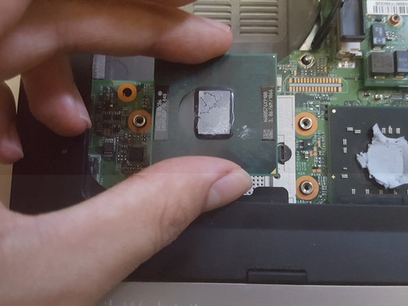

    1. HP EliteBook 8530w CPU Replacement, CPU: step 7, image 1 of 2 HP EliteBook 8530w CPU Replacement, CPU: step 7, image 2 of 2
      • Unscrew the socket mount with a flat head screwdriver to unlock the CPU.
      • Turn it counter clockwise, towards the "unlock" symbol on the socket.
      Ask FixBot
    2. HP EliteBook 8530w CPU Replacement: step 8, image 1 of 2 HP EliteBook 8530w CPU Replacement: step 8, image 2 of 2
      • Hold the CPU from the edges to pull it up and remove it.
      Ask FixBot
    3. HP EliteBook 8530w CPU Replacement: step 9, image 1 of 1
      • Retrieve your replacement CPU.
      • Point the small golden triangle on the new CPU to the bottom right.
      • The small golden triangle on the CPU should align with the one on the socket. This cannot be seen due to obstruction caused by the laptop chassis.
      Ask FixBot
    4. HP EliteBook 8530w CPU Replacement: step 10, image 1 of 2 HP EliteBook 8530w CPU Replacement: step 10, image 2 of 2
      • Align and insert the pins on the CPU with the socket.
      • Ensure that you keep the small golden triangle on the CPU in the same position from last step.
      Ask FixBot
    5. HP EliteBook 8530w CPU Replacement: step 11, image 1 of 1
      Ask FixBot
    6. HP EliteBook 8530w CPU Replacement: step 12, image 1 of 1
      • Screw the socket mount with a flathead screwdriver to lock the CPU into place.
      • Ensure you turn the screw clockwise, towards the "lock" symbol.
      Ask FixBot
