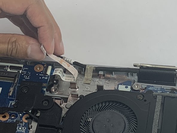

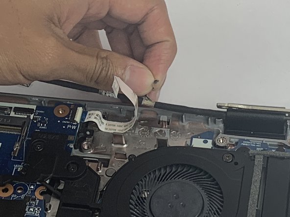

  19. HP EliteBook 850 G3 Display Assembly Replacement: step 19, image 1 of 3 HP EliteBook 850 G3 Display Assembly Replacement: step 19, image 2 of 3 HP EliteBook 850 G3 Display Assembly Replacement: step 19, image 3 of 3
    • Disconnect wire over gold tape and remove tape. You will have to peel the wire up to get to the tape.
    • The tape is not reusable.

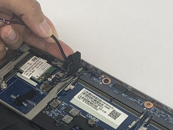

  20. HP EliteBook 850 G3 Display Assembly Replacement: step 20, image 1 of 2 HP EliteBook 850 G3 Display Assembly Replacement: step 20, image 2 of 2
    • Remove the coaxial cables from the wifi card and from clear plastic holds. Remove the black tape and slip out from black clip.
    • This tape is not reusable.

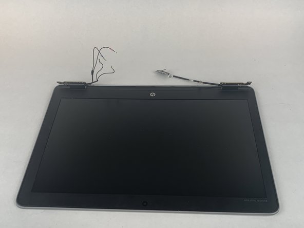

  22. HP EliteBook 850 G3 Display Assembly Replacement: step 22, image 1 of 2 HP EliteBook 850 G3 Display Assembly Replacement: step 22, image 2 of 2
    • Take the display assembly off.
