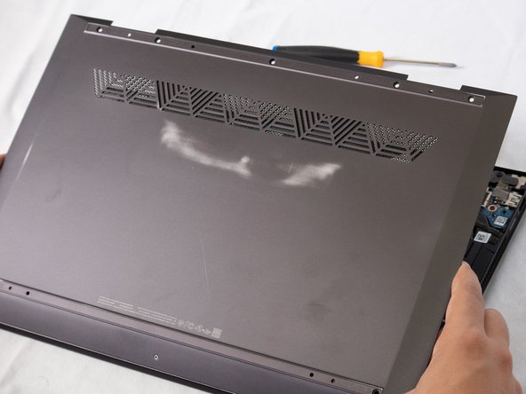

  3. HP DS0011 DX Battery and M2 Replacement, Remove Back Cover: step 3, image 1 of 2 HP DS0011 DX Battery and M2 Replacement, Remove Back Cover: step 3, image 2 of 2
    • Approach the back cover from the corners and pry it off with a flathead so that the m.2 is exposed.

  10. HP DS0011 DX Battery and M2 Replacement, Put Back Cover Back On: step 10, image 1 of 2 HP DS0011 DX Battery and M2 Replacement, Put Back Cover Back On: step 10, image 2 of 2
    • After completely screwing in the battery and m2, put the back cover on by putting it on the magnetic contact and pushing it down into the clips.
