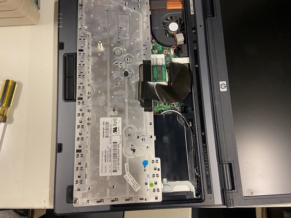

    4. HP Compaq 6510b CPU Replacement, Keyboard: step 4, image 1 of 3 HP Compaq 6510b CPU Replacement, Keyboard: step 4, image 2 of 3 HP Compaq 6510b CPU Replacement, Keyboard: step 4, image 3 of 3
      • Put the screen in a 180 degree position.
      • Gently pull the keyboard up at the display side.
      • Slide the keyboard to the display.
      • Flip the keyboard so the keys are touching the trackpad.

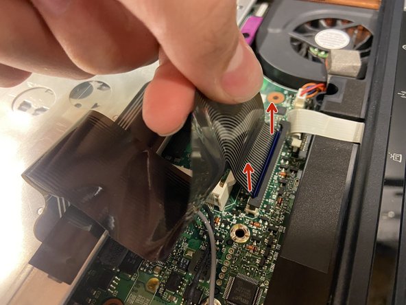

    5. HP Compaq 6510b CPU Replacement, Keyboard cable: step 5, image 1 of 2 HP Compaq 6510b CPU Replacement, Keyboard cable: step 5, image 2 of 2
      • Fold the ribbon cable back so you can access the connection.
      • Pull the black part of the connector up to unlock the cable.
      • Pull the ribbon cable up to disconnect it.

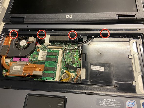

    6. HP Compaq 6510b CPU Replacement, Power Button panel: step 6, image 1 of 2 HP Compaq 6510b CPU Replacement, Power Button panel: step 6, image 2 of 2
      • Disconnect the ribbon cable that connects to the top panel and remove the second RAM stick.
      • Insert a flat head screwdriver into the holes circled and rotate 90 degrees to pop the plastic clips.

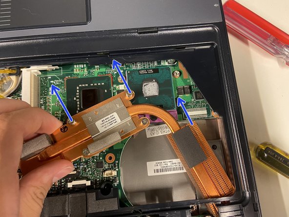

    8. HP Compaq 6510b CPU Replacement, Cooler: step 8, image 1 of 3 HP Compaq 6510b CPU Replacement, Cooler: step 8, image 2 of 3 HP Compaq 6510b CPU Replacement, Cooler: step 8, image 3 of 3
      • Unscrew the cooler screws in the reverse order - 4 3 2 1.
      • Pry with a flathead to unstick the thermal pad on the chipset. (It can hold on pretty tight)
      • Pull the cooler up a bit on the CPU side, then rotate it as demonstrated in the second photo.
      • When the chipset pad has roughly reached the keyboard connector, pull it out in the direction of the coin cell battery.

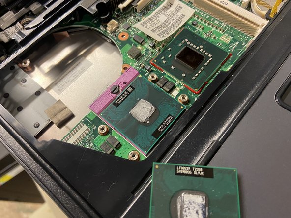

    9. HP Compaq 6510b CPU Replacement, CPU: step 9, image 1 of 3 HP Compaq 6510b CPU Replacement, CPU: step 9, image 2 of 3 HP Compaq 6510b CPU Replacement, CPU: step 9, image 3 of 3
      • Use the flathead screwdriver to rotate the lock to the unlocked position.
      • Grab the CPU as shown. This way the pins are not likely to get bent.
      • Place the new CPU in the socket.
      Ask FixBot
    10. HP Compaq 6510b CPU Replacement, Alignment: step 10, image 1 of 1
      • Make sure the "star" on the CPU is aligned with the socket.
      Ask FixBot
