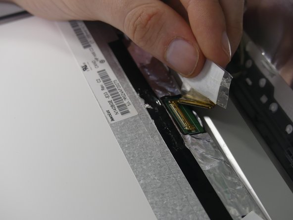

  6. HP Chromebook 14-x013dx Screen Replacement: step 6, image 1 of 3 HP Chromebook 14-x013dx Screen Replacement: step 6, image 2 of 3 HP Chromebook 14-x013dx Screen Replacement: step 6, image 3 of 3
    • Before completely removing the screen, detach the connected located at the bottom of the screen.
    • The connection to be removed should have a barcode marking.
