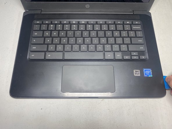

    • Flip the laptop over and open up the display.
    • Using a opening pick, carefully separate the top housing from the bottom housing by working your way around the perimeter of the laptop and prying it open.

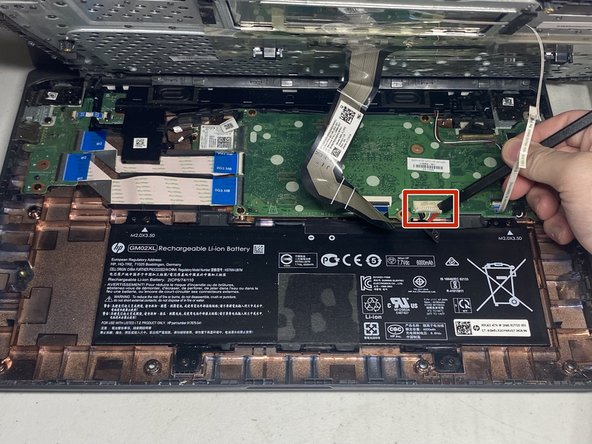

    • Peel back the black tape covering the battery connector.
    • Using the spudger, unplug the battery connector from the motherboard.

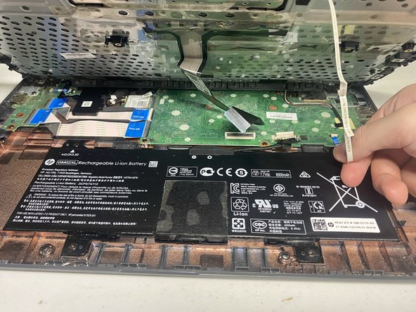

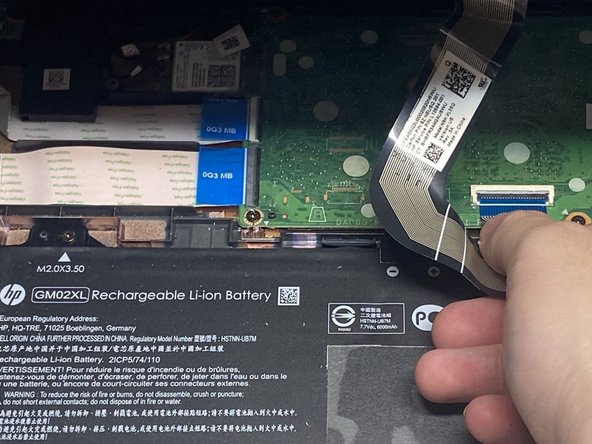

    • Carefully lift the keyboard ribbon lock with the spudger and disconnect the keyboard ribbon cable from the motherboard.
  6. HP Chromebook 14 G5 Wi-Fi Card Replacement: step 6, image 1 of 2 HP Chromebook 14 G5 Wi-Fi Card Replacement: step 6, image 2 of 2
    • Carefully lift the touch pad ribbon lock with the spudger and disconnect the touch pad ribbon cable from the motherboard.
    • Remove the keyboard assembly from the device housing.

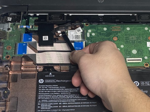

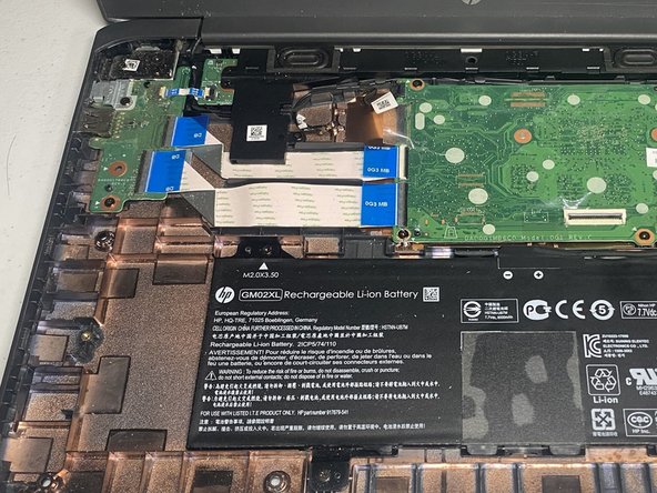

    • Using the spudger, disconnect the two antennas from the Wi-Fi card.
  8. HP Chromebook 14 G5 Wi-Fi Card Replacement: step 8, image 1 of 1
    • Using a Phillips #0 screwdriver, remove the screw securing the Wi-Fi card.
  9. HP Chromebook 14 G5 Wi-Fi Card Replacement: step 9, image 1 of 2 HP Chromebook 14 G5 Wi-Fi Card Replacement: step 9, image 2 of 2
    • Gently remove the Wi-Fi card.
