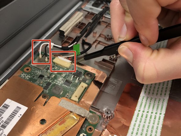

  10. HP Chromebook  14-x013dx Motherboard Replacement, Motherboard: step 10, image 1 of 3 HP Chromebook  14-x013dx Motherboard Replacement, Motherboard: step 10, image 2 of 3 HP Chromebook  14-x013dx Motherboard Replacement, Motherboard: step 10, image 3 of 3
    • Carefully remove the 4 connections.

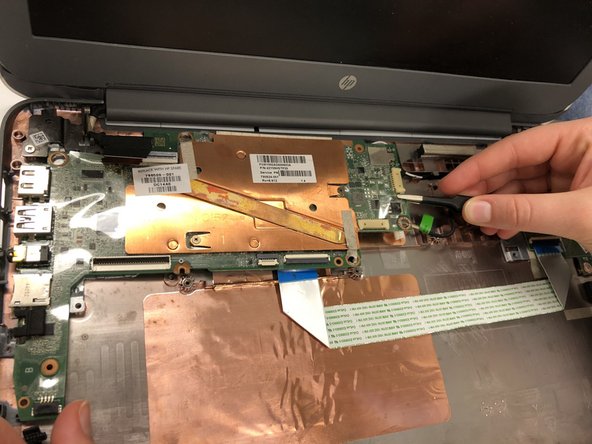

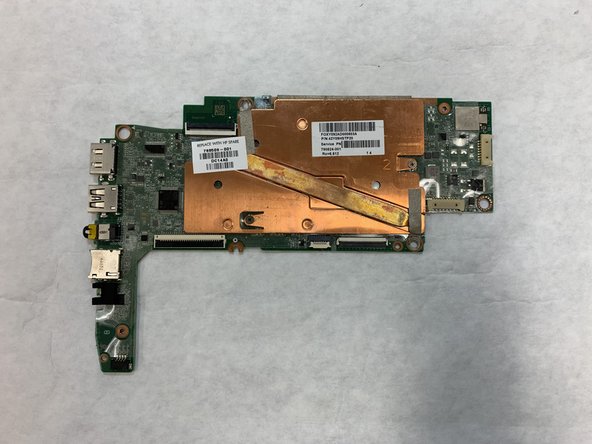

  11. HP Chromebook  14-x013dx Motherboard Replacement: step 11, image 1 of 3 HP Chromebook  14-x013dx Motherboard Replacement: step 11, image 2 of 3 HP Chromebook  14-x013dx Motherboard Replacement: step 11, image 3 of 3
    • Using a Phillips #00 screwdriver, remove the seven 2mm screws holding the motherboard in place.
    • Gently lift the motherboard out of the laptop case.
