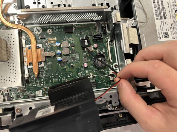

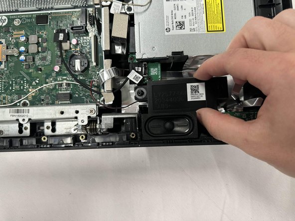

  11. HP All-in-one PC Model 24 Motherboard Replacement, Removing the Speakers: step 11, image 1 of 3 HP All-in-one PC Model 24 Motherboard Replacement, Removing the Speakers: step 11, image 2 of 3 HP All-in-one PC Model 24 Motherboard Replacement, Removing the Speakers: step 11, image 3 of 3
    • Locate the Speakers: There should be the left and right speakers.
    • Disconnect the Speaker Cables: Gently disconnect the cables by pulling the wires directly above the plugs perpendicular to the board.
    • Remove the Speakers: Carefully lift the speakers out of their compartments. To lift them they have to be pushed down and out of the locking studs. Be careful not to lose the rubber gaskets that go around the locking studs.
