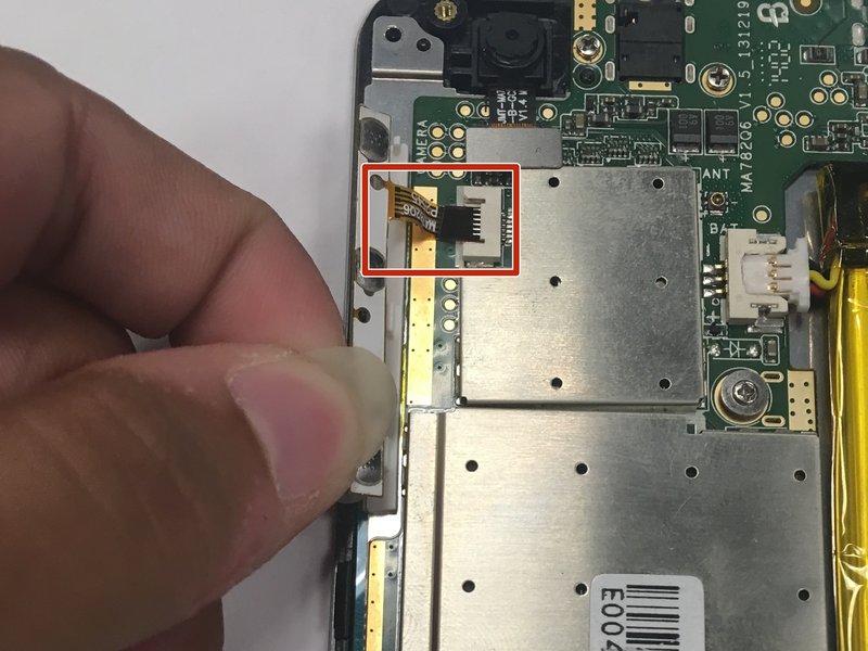

  4. HP 8 1401 Power/ Volume Button Board Replacement, Power/ Volume Button Board: step 4, image 1 of 3 HP 8 1401 Power/ Volume Button Board Replacement, Power/ Volume Button Board: step 4, image 2 of 3 HP 8 1401 Power/ Volume Button Board Replacement, Power/ Volume Button Board: step 4, image 3 of 3
    • Disconnect the power/ volume button board from the control board by pulling the ribbon cable out of the white connector. You can use tweezers or your fingers.
  5. HP 8 1401 Power/ Volume Button Board Replacement: step 5, image 1 of 1
    • After removing the power/ volume button board, it should look like this.
