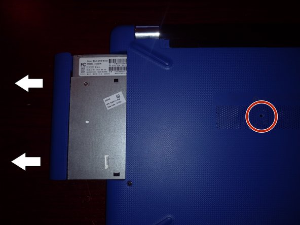

      • For the CD Drive; Remove the screw in the middle of the device (the one on the vent) And slide the entire CD drive out from the side of the laptop.
