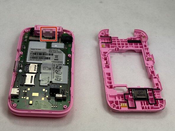

    1. HMD Barbie Screen Replacement, Motherboard: step 5, image 1 of 3 HMD Barbie Screen Replacement, Motherboard: step 5, image 2 of 3 HMD Barbie Screen Replacement, Motherboard: step 5, image 3 of 3
      • Use the opening tool to remove the clear plastic clip near the hinge of the phone securing the motherboard.

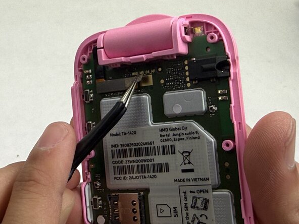

    2. HMD Barbie Screen Replacement: step 6, image 1 of 3 HMD Barbie Screen Replacement: step 6, image 2 of 3 HMD Barbie Screen Replacement: step 6, image 3 of 3
      • The video ribbon is connected to the motherboard with a flat-topped, low profile connector. It is also secured with a piece of tape.
      • Use the tweezers to gently unstick the tape from the motherboard, leaving it stuck to the connector.
      • Use the tweezers to gently pull up on the connector until it disconnects from the motherboard.
      • Be gentle as you apply pressure on the tape and connector. These parts shouldn't take too much force to remove.

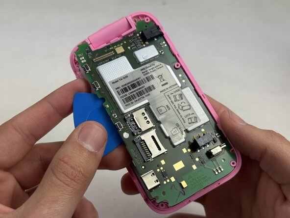

    3. HMD Barbie Screen Replacement: step 7, image 1 of 3 HMD Barbie Screen Replacement: step 7, image 2 of 3 HMD Barbie Screen Replacement: step 7, image 3 of 3
      • Beginning at the corner near where the video ribbon is located, insert an opening pick between the green motherboard and the pink housing.
      • Slowly work your way around the motherboard until it loosens enough that you can use your fingers to remove it.

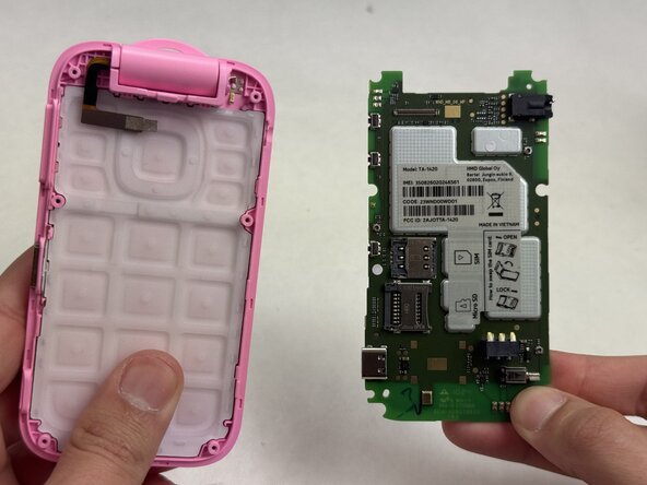

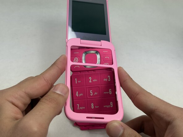

    1. HMD Barbie Screen Replacement, Keypad: step 8, image 1 of 3 HMD Barbie Screen Replacement, Keypad: step 8, image 2 of 3 HMD Barbie Screen Replacement, Keypad: step 8, image 3 of 3
      • Push the keypad out of the outer casing from the front of the phone, outward.
      • You may now replace the keypad with a new one, inserting it where the old keypad was. Make sure to not obstruct any of the holes for screws with the keypad.
      Ask FixBot

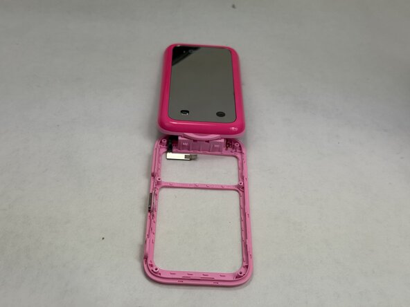

    1. HMD Barbie Screen Replacement, Screen: step 9, image 1 of 1
      • Remove all removable components from the device housing: the battery, inner backplate, motherboard, and keypad.
      • As this device is a flip phone, the screen is part of the device housing, so you will need to transfer the inner parts to a new device housing in order to replace the screen.
