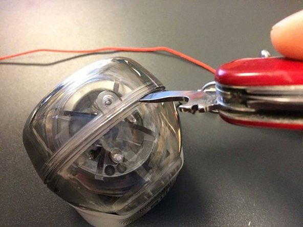

    3. Gyroscopic exercise tool (Powerball) Roller Fix, Split housing: step 3, image 1 of 1
      • Use some flat tool, I used small blade of my Swiss Army knife but spudger should be a better choice. Pry one half from the other. You will hear loud click and then it should open.
