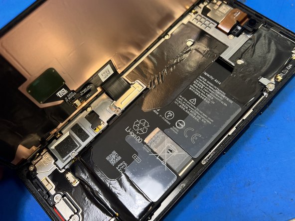

    3. Google Pixel 6 Screen Replacement, Screen removal: step 3, image 1 of 2 Google Pixel 6 Screen Replacement, Screen removal: step 3, image 2 of 2
      • start lifting screen from bottom of the phone
      • LCD connector is located left side of the phone, so you should work your way counter-clock wise.
      Ask FixBot

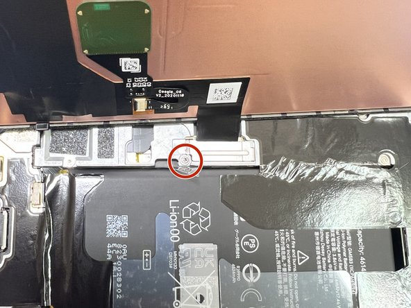

    4. Google Pixel 6 Screen Replacement, Remove connector cover: step 4, image 1 of 3 Google Pixel 6 Screen Replacement, Remove connector cover: step 4, image 2 of 3 Google Pixel 6 Screen Replacement, Remove connector cover: step 4, image 3 of 3
      • Lift screen from right to left.
      • Use T3 Torx driver to remove screw to remove FPC cover.
      Ask FixBot

    6. Google Pixel 6 Screen Replacement, Fingerprint sensor removal: step 6, image 1 of 3 Google Pixel 6 Screen Replacement, Fingerprint sensor removal: step 6, image 2 of 3 Google Pixel 6 Screen Replacement, Fingerprint sensor removal: step 6, image 3 of 3
      • The sensor is attached to screen with adhesive. DO NOT FORCE to remove, it can easily tear.
      • Apply 100C heat around the flex.
      • Gently work around to remove flex off screen.
      Ask FixBot
