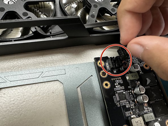

    • Remove the four springs screws attached to the thermal plate on the GPU using a Phillips #00 screwdriver.
    • Remove the two screws from the right side using a Phillips #00 screwdriver.
    • Remove the two screws from the left side using a Phillips #00 screwdriver.

    • Lift the backplate off after the screws are removed.
    • You will notice both sides of the card have a cable holding the cover and the main GPU board.
    • Carefully remove the connector at the top of the GPU (the side with GEFORCE RTX like on the picture) connecting the GPU board and the fan cover.

    • Remove the connector associated with the fan.
    • Pull the fan out with its connector cable intact.
