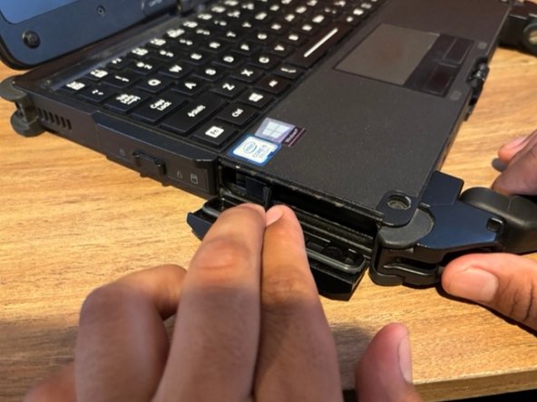

    3. Getac V110 Battery Replacement: step 3, image 1 of 3 Getac V110 Battery Replacement: step 3, image 2 of 3 Getac V110 Battery Replacement: step 3, image 3 of 3
      • Gain access to battery by : Sliding the lock to right.
      • Folding the lock down.
      • Move battery strap to right.
      Ask FixBot
