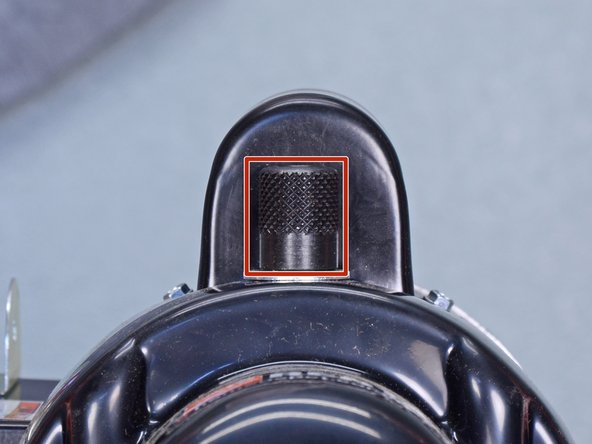

    • Before you begin, make sure the drain cleaner is disconnected from power.
    • Loosen the belt guard knob enough to be able to slide the belt guard toward the front of the drain cleaner.

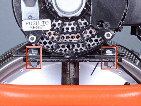

    • Use two 1/2 inch wrenches to remove the four nut and bolt sets securing the motor to the drain cleaner.
    • During reassembly, make sure that the belt pulley on the motor is lined up with the belt groove on the cage before tightening the bolts.
  5. General Pipe Cleaners Drain Cleaner EJB 2014 Motor Assembly Replacement: step 5, image 1 of 1
    • Remove the motor assembly.
