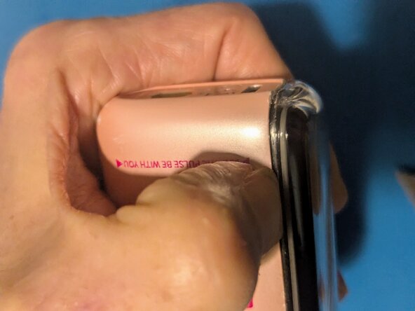

    3. Geek Bar Pulse Refill: step 6, image 1 of 3 Geek Bar Pulse Refill: step 6, image 2 of 3 Geek Bar Pulse Refill: step 6, image 3 of 3
      • Position your thumbnail on the seam near the bottom of the vape.
      • Work your utility knife into the two high points of the case on the bottom.
      • Pry the near side of the case far enough open to get your fingernail into the gap to keep it open.

    4. Geek Bar Pulse Refill: step 7, image 1 of 3 Geek Bar Pulse Refill: step 7, image 2 of 3 Geek Bar Pulse Refill: step 7, image 3 of 3
      • Insert your knife and slide it down, then use it to lever the top of the vape out of the case.
      • Using the knife, go back to the bottom and lever the opposite side out.
      • On the other side, insert the knife and use it to pop the clips on that side.
      Ask FixBot
