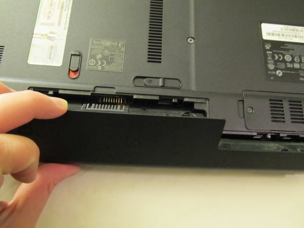

  3. Gateway NV53A24u LCD Screen Replacement: step 3, image 1 of 1
    • Remove the battery by sliding the clips to "unlocked."

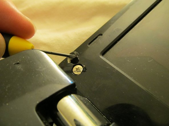

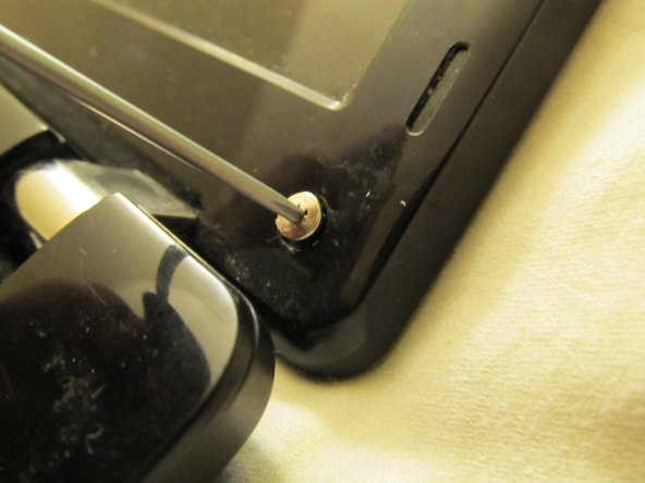

  4. Gateway NV53A24u LCD Screen Replacement: step 4, image 1 of 2 Gateway NV53A24u LCD Screen Replacement: step 4, image 2 of 2
    • Remove the plastic covers that are on top of the screws you're after.
    • These plastic covers are NOT like anything I've seen. You will need to carefully apply a LOT of force to get these to finally "bend" off the hole. Be careful not to scratch anything.
    • This is the shortcut way to perform this screen replacement operation, and by far the easiest. Other tutorials will have you disassemble the entire unit.
    • Once the plastics are off, remove the two screws (one in the bottom left, one in the bottom right).

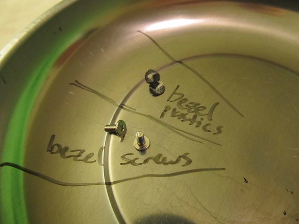

  5. Gateway NV53A24u LCD Screen Replacement: step 5, image 1 of 1
    • As my tutorials will always instruct, keep track of your screws with a dry erase marker on your magnet bowl.

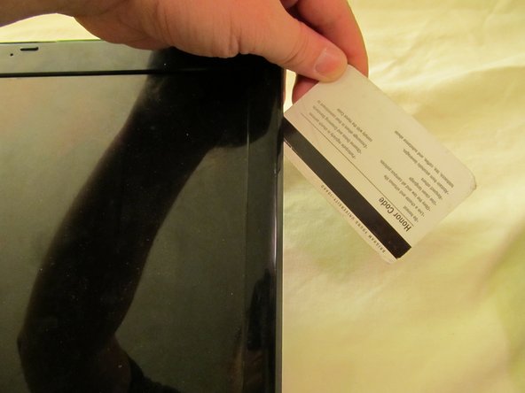

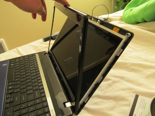

  6. Gateway NV53A24u LCD Screen Replacement: step 6, image 1 of 1
    • Slide a credit card along the edges of the bezel to lift the bezel away from the LCD.
  7. Gateway NV53A24u LCD Screen Replacement: step 7, image 1 of 1
    • Lean the screen all the way into the open position, and get your small flatheat screwdriver into the circular opening that is the hinge.
    • Pry upwards gently until the hinge portion of the bezel comes off, allowing you to remove the bezel completely.
  8. Gateway NV53A24u LCD Screen Replacement: step 8, image 1 of 2 Gateway NV53A24u LCD Screen Replacement: step 8, image 2 of 2
    • Remove the front bezel. (I'll leave it there as long as I can throughout the rest of the tutorial to demonstrate where it used to be)

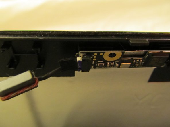

  10. Gateway NV53A24u LCD Screen Replacement: step 10, image 1 of 2 Gateway NV53A24u LCD Screen Replacement: step 10, image 2 of 2
    • Before lying the LCD flat on it's face, we must disconnect the webcam cable located in the dead-center of this photo. A gentle tug will do.
    • Now that the LCD is free from the webcam, lie it down on its face. DO NOT attempt to remove it yet. The LCD ribbon cable is still connected.

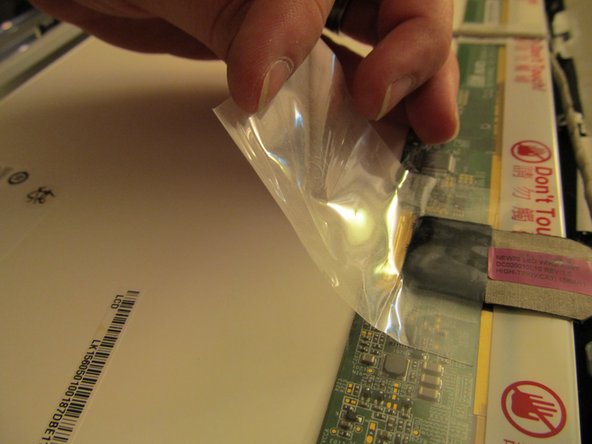

  11. Gateway NV53A24u LCD Screen Replacement: step 11, image 1 of 2 Gateway NV53A24u LCD Screen Replacement: step 11, image 2 of 2
    • Gently pull the tape off the LCD back.
    • Once enough tape has been removed, you'll be able to pull backwards on the ribbon cable to release it. Nothing holds this in place but tape, so be sure to suture it back up with your new LCD using the same tape.
  12. Gateway NV53A24u LCD Screen Replacement: step 12, image 1 of 1
    • Finally, remove the webcam cable from the back of the old LCD. It's held on by 'spot-tape,' where some points are sticky and others aren't.
  13. Gateway NV53A24u LCD Screen Replacement: step 13, image 1 of 1
    • Place your new LCD face-down where your old one used to be, and go backwards through the guide from here.
