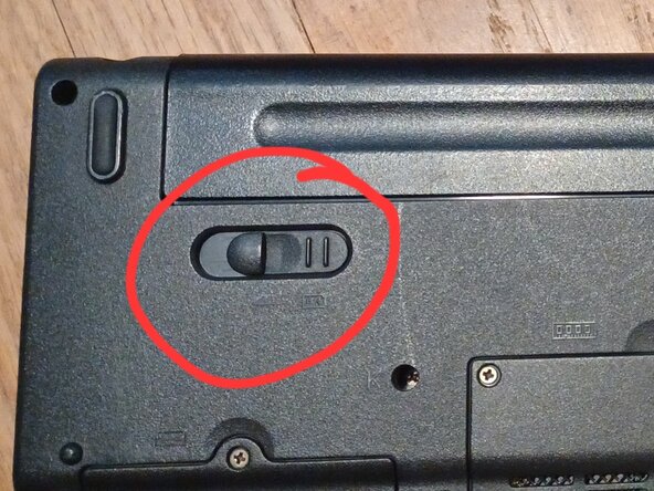

    1. Gateway MT6728 Battery Replacement, Location Switches: step 1, image 1 of 3 Gateway MT6728 Battery Replacement, Location Switches: step 1, image 2 of 3 Gateway MT6728 Battery Replacement, Location Switches: step 1, image 3 of 3
      • First ensure the laptop is powered off and the charger unplugged.
      • Second, flip the the laptop over. The battery should be at the top center.
      • Third, locate the switches circled in the photo.

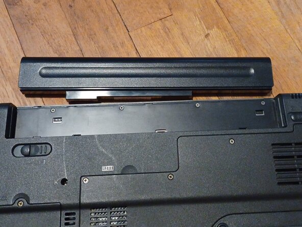

    2. Gateway MT6728 Battery Replacement, Removing The battery: step 2, image 1 of 2 Gateway MT6728 Battery Replacement, Removing The battery: step 2, image 2 of 2
      • Make sure the switch on the right side is in the unlocked position.
      • Move and hold the left switch, to the left. Remove the battery by sliding it out while the left switch is held.
      Ask FixBot
To reinsert the new battery, just slide it in. You do not need to hold the left lever.
