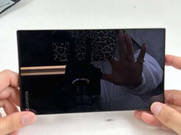

    1. Garmin DriveSmart 71 EX Case Disassembly, Case: step 1, image 1 of 1
      • Unplug and power off the device.
