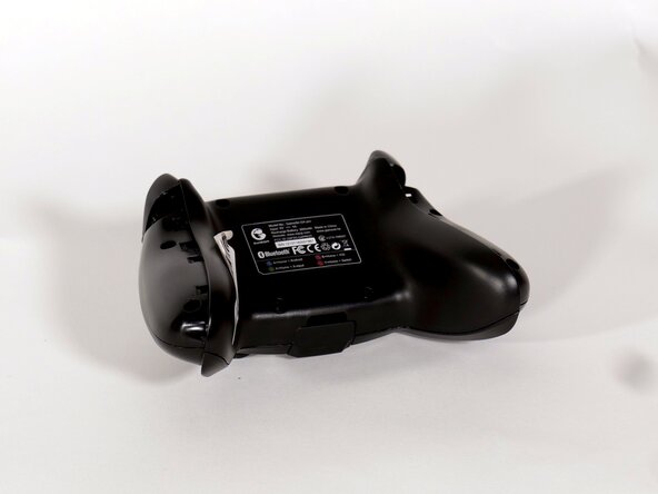

      • Remove the dongle from the controller.

    2. GameSir G4 Pro Buttons Replacement: step 2, image 1 of 2 GameSir G4 Pro Buttons Replacement: step 2, image 2 of 2
      • Use a metal spudger to remove the rubber screw caps on the rear case.
      Ask FixBot
