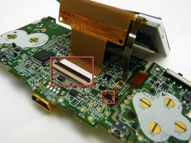

    1. Game Boy Micro Motherboard Replacement, Motherboard: step 17, image 1 of 3 Game Boy Micro Motherboard Replacement, Motherboard: step 17, image 2 of 3 Game Boy Micro Motherboard Replacement, Motherboard: step 17, image 3 of 3
      • The LCD screen is connected to the motherboard by two ribbon cables.
      • Use a plastic spudger to disconnect the LCD's ZIF connector.
      Ask FixBot
    2. Game Boy Micro Motherboard Replacement: step 18, image 1 of 3 Game Boy Micro Motherboard Replacement: step 18, image 2 of 3 Game Boy Micro Motherboard Replacement: step 18, image 3 of 3
      • Use the tip of the spudger to lift the small, black tab holding the thin ribbon.
      • With both tabs lifted, pull the ribbons off the motherboard and remove the LCD screen.
      Ask FixBot
