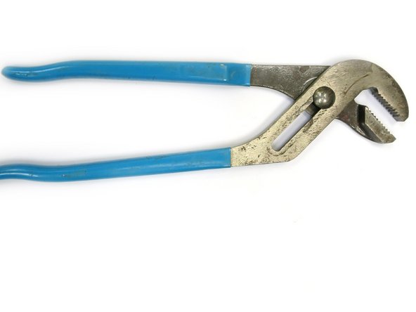

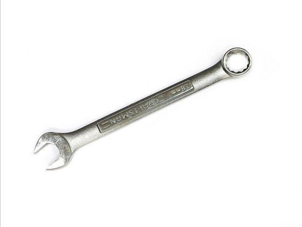

      • Phillips screwdriver
      • Flathead screwdriver
      • 5mm T Allen wrench
      • Plier wrench
      • 18mm open wrench

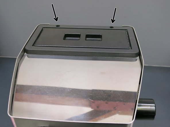

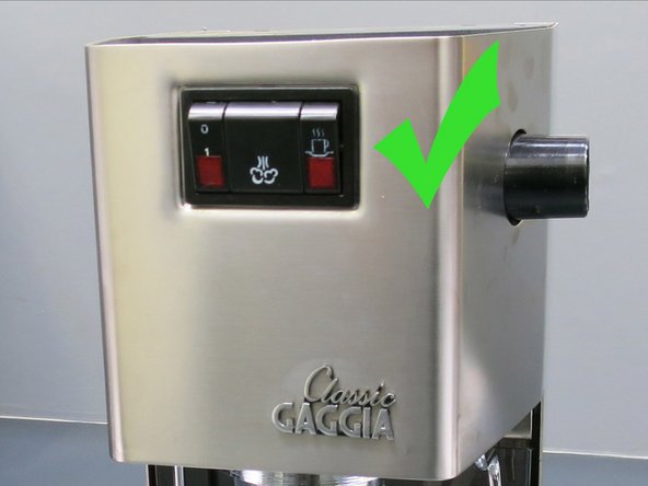

    2. Gaggia Classic Steam Valve replacement, Remove The Top Of The Machine: step 2, image 1 of 3 Gaggia Classic Steam Valve replacement, Remove The Top Of The Machine: step 2, image 2 of 3 Gaggia Classic Steam Valve replacement, Remove The Top Of The Machine: step 2, image 3 of 3
      • Use the philips screwdriver to open the two screws on the top of the machine.
      • Lift the top cover and put it on the side.
      • Look inside and you will see the brass valve that attached to the steam knob(black arrow), the 2 allen screws (green arrows) and the copper (or stainless steel) steam wand pipe(red arrow).

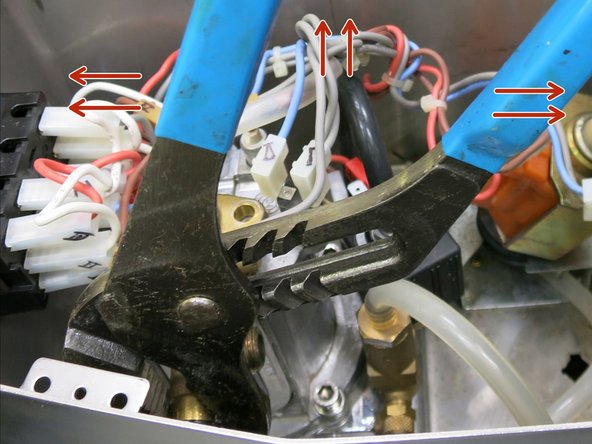

    3. Gaggia Classic Steam Valve replacement, Remove The Steam Knob: step 3, image 1 of 2 Gaggia Classic Steam Valve replacement, Remove The Steam Knob: step 3, image 2 of 2
      • Pull the steam knob out. If its too hard, try to gently pry it out with a flathead screwdriver from the inner side of the machine.
      • Please be careful not to damage the plastic steam knob. Sometimes it can be fragile.

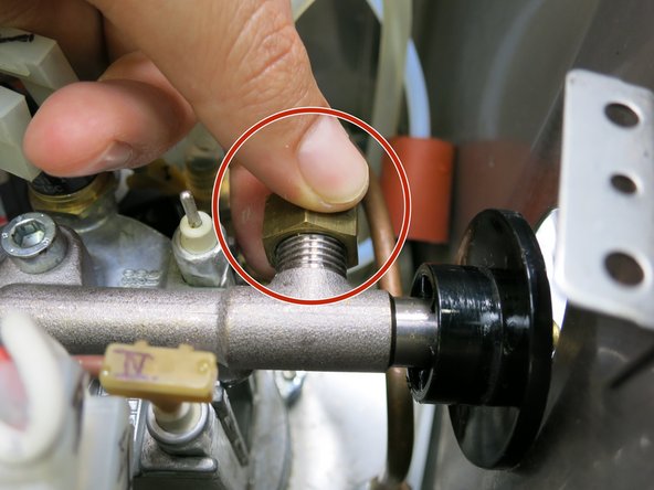

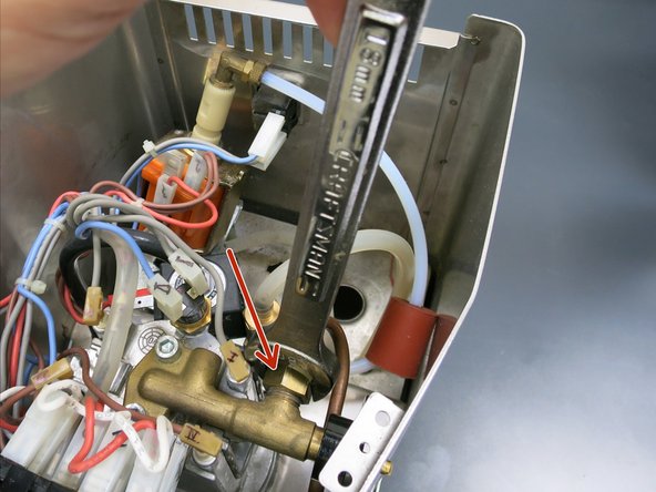

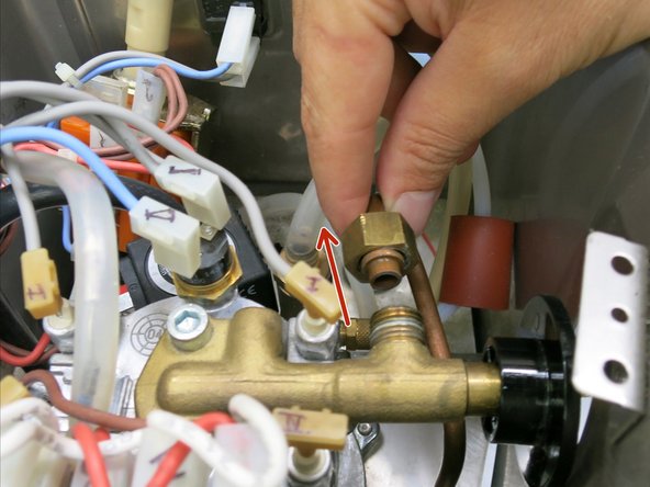

    4. Gaggia Classic Steam Valve replacement, Remove Attachments From Steam Valve: step 4, image 1 of 3 Gaggia Classic Steam Valve replacement, Remove Attachments From Steam Valve: step 4, image 2 of 3 Gaggia Classic Steam Valve replacement, Remove Attachments From Steam Valve: step 4, image 3 of 3
      • Use The 18mm wrench to open the hex nut.
      • Pull the copper pipe to the side so it wont be in the way.

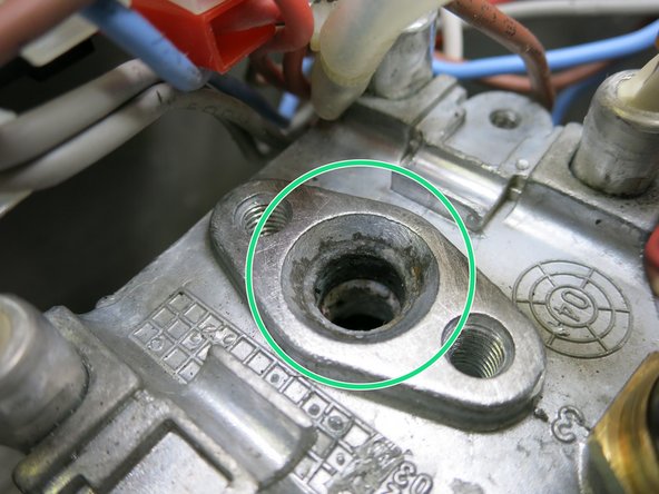

    7. Gaggia Classic Steam Valve replacement, Cleaning The Surface: step 7, image 1 of 3 Gaggia Classic Steam Valve replacement, Cleaning The Surface: step 7, image 2 of 3 Gaggia Classic Steam Valve replacement, Cleaning The Surface: step 7, image 3 of 3
      • Now its time to clean the old gasket marks from the boiler
      • Use a wire brush to do the job
      • Please make sure the top of the boiler is clear from any objects (screws) that might fall into the open hole.

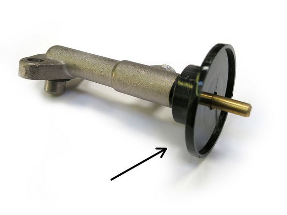

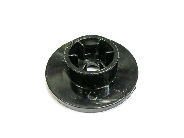

    8. Gaggia Classic Steam Valve replacement, Prepearing The New Valve: step 8, image 1 of 3 Gaggia Classic Steam Valve replacement, Prepearing The New Valve: step 8, image 2 of 3 Gaggia Classic Steam Valve replacement, Prepearing The New Valve: step 8, image 3 of 3
      • In the Kit you will find the new stainless steel valve with a black gasket and a small bag with food grade lube.
      • Lets get the valve ready to be installed! First, use the lube from the bag on the gasket and make sure its clean.
      • Second, place the plastic guard on the end of the valve with the flat side facing out.

Done successfully. Note that it is not an 18mm nut for the steam connection. The correct size is 17mm. If you look closely in the picture, the 18mm wrench is fairly loose on the nut.
tresaudio - Reply Share
It is a 17mm nut, correct
