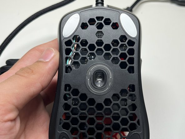

      • Flip your mouse upside down.

      • Peel off the back right mouse skate.
      • Peel slowly, you don't want to create bends on your skate.
      Ask FixBot
    3. G-Wolves Hati Paracord Replacement: step 3, image 1 of 3 G-Wolves Hati Paracord Replacement: step 3, image 2 of 3 G-Wolves Hati Paracord Replacement: step 3, image 3 of 3
      • Peel off the back left mouse skate.

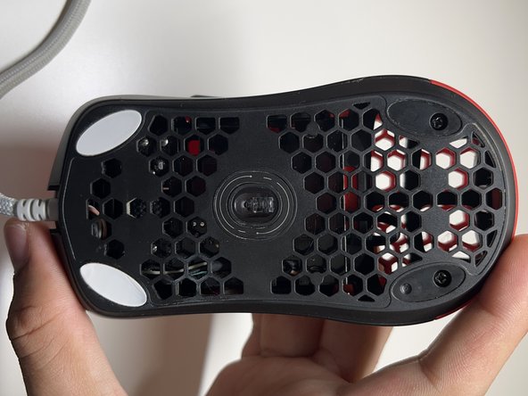

    4. G-Wolves Hati Paracord Replacement: step 4, image 1 of 3 G-Wolves Hati Paracord Replacement: step 4, image 2 of 3 G-Wolves Hati Paracord Replacement: step 4, image 3 of 3

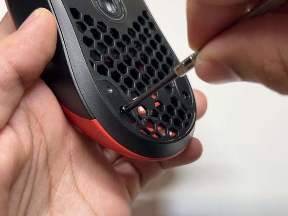

      • Unscrew both of the uncovered screws.
      • 6.4mm Phillips-head screws.
      Ask FixBot

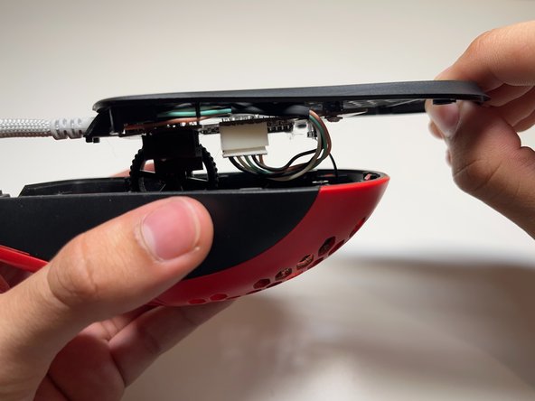

      • Squeeze the mouse under second mouse button until the bottom opens.
      Ask FixBot
    6. G-Wolves Hati Paracord Replacement: step 6, image 1 of 2 G-Wolves Hati Paracord Replacement: step 6, image 2 of 2
      • Pull the bottom piece towards the back of the mouse and upwards to remove it.
      • Pull carefully there is a ribbon cable still connected.

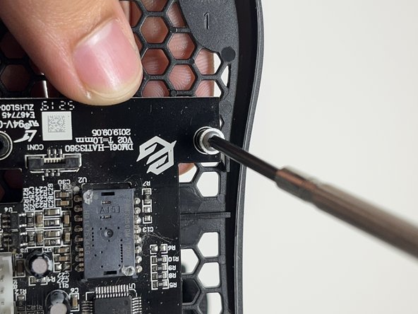

    8. G-Wolves Hati Paracord Replacement: step 8, image 1 of 2 G-Wolves Hati Paracord Replacement: step 8, image 2 of 2
      • Unscrew the following screws:
      • 4.8 mm Phillips-head screws.
      Ask FixBot

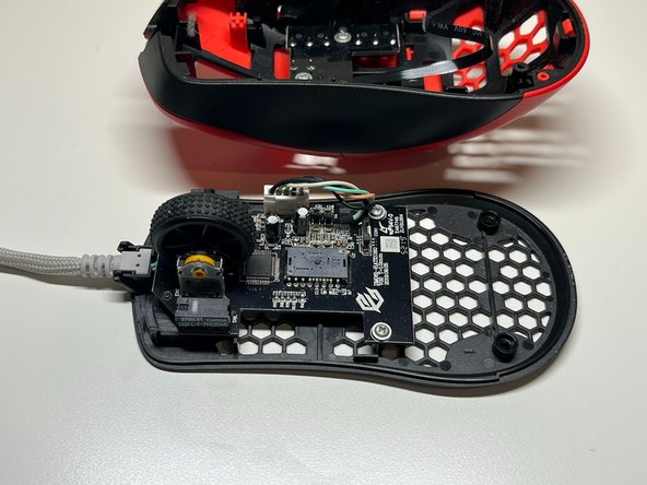

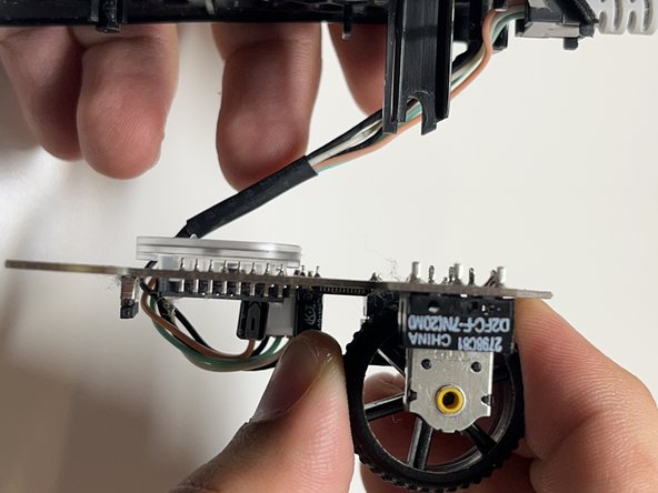

    9. G-Wolves Hati Paracord Replacement: step 9, image 1 of 2 G-Wolves Hati Paracord Replacement: step 9, image 2 of 2
      • Flip the bottom piece upside down.
      • Pull the circuit board off without pulling on the cable.
      Ask FixBot

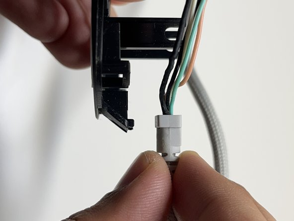

    10. G-Wolves Hati Paracord Replacement: step 10, image 1 of 3 G-Wolves Hati Paracord Replacement: step 10, image 2 of 3 G-Wolves Hati Paracord Replacement: step 10, image 3 of 3
      • Grab the side ridges and remove the connection.
      • Do not wiggle till slightly removed to not bend pins.
      Ask FixBot
    11. G-Wolves Hati Paracord Replacement: step 11, image 1 of 2 G-Wolves Hati Paracord Replacement: step 11, image 2 of 2

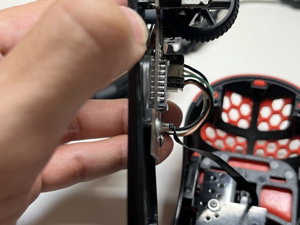

      • Pop off the paracord from the bottom piece.
      Ask FixBot

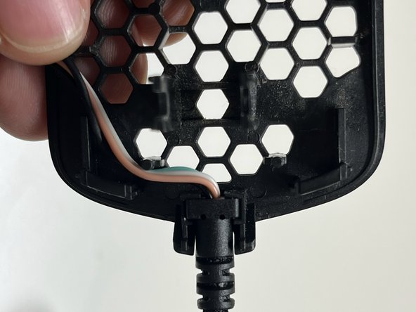

    13. G-Wolves Hati Paracord Replacement: step 13, image 1 of 3 G-Wolves Hati Paracord Replacement: step 13, image 2 of 3 G-Wolves Hati Paracord Replacement: step 13, image 3 of 3
      • Rearrange wires to follow the guide ridges.
      Ask FixBot

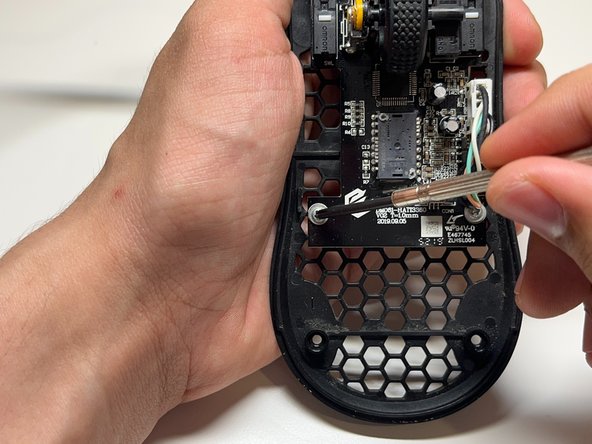

    15. G-Wolves Hati Paracord Replacement: step 15, image 1 of 2 G-Wolves Hati Paracord Replacement: step 15, image 2 of 2
      • Re-insert the screws.
      Ask FixBot
    16. G-Wolves Hati Paracord Replacement: step 16, image 1 of 2 G-Wolves Hati Paracord Replacement: step 16, image 2 of 2

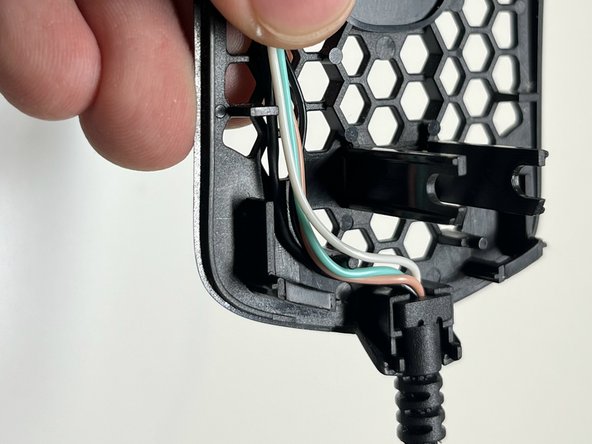

      • Thread the wire through the side opening.
      • Insert the paracord connection.
      Ask FixBot

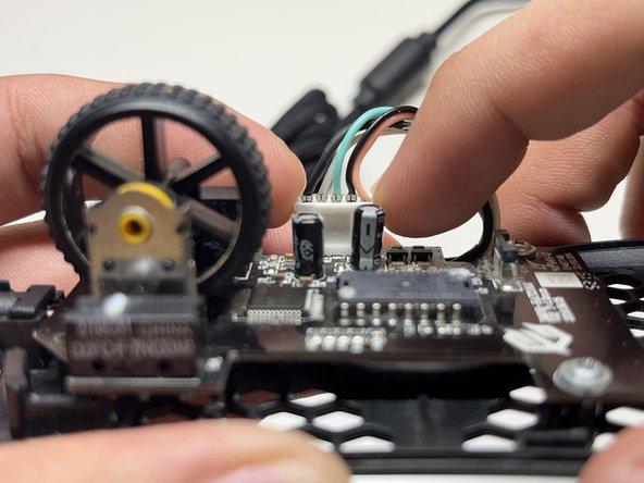

    17. G-Wolves Hati Paracord Replacement: step 17, image 1 of 2 G-Wolves Hati Paracord Replacement: step 17, image 2 of 2
      • Insert the ribbon cable.
      • Cable is located on the upper mouse piece.
      Ask FixBot

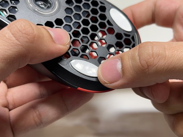

    20. G-Wolves Hati Paracord Replacement: step 20, image 1 of 3 G-Wolves Hati Paracord Replacement: step 20, image 2 of 3 G-Wolves Hati Paracord Replacement: step 20, image 3 of 3
      • Press on the skates.
