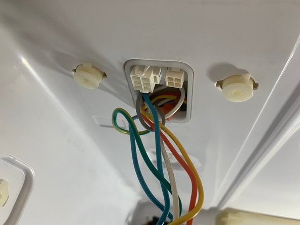

    • After removing the ice tray, this model changes: there is only a single screw on the side with a 5/16" hex head and two dovetail pegs at the top holding the "ice maker compartment" in
    • In the photo you can see the pegs and in the corner you can see the insert where the hex head screw is inserted. Once that screw is removed you should be able to just pull straight out (towards you) and the box will come out. Be mindful of the wires coming through the top of the box
    • NOTE: it can take some serious force to remove the compartment. Mine was frozen to the back panel. I used a heat gun in my removal process because it did not come easily, I was unsure what was holding it and didn't want to damage parts

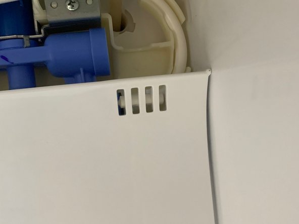

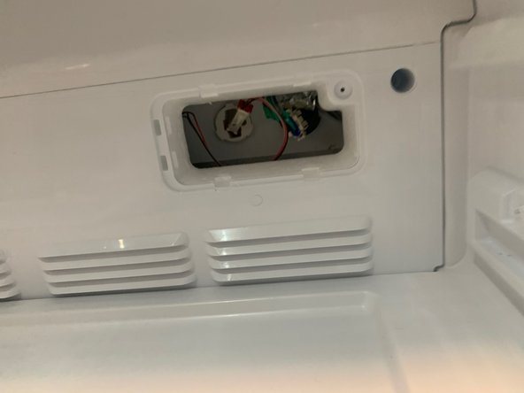

    • The back panel has two screws in pockets on its lower third and 2 hiden screws. one in the air filter cover and the other in the lower cover. the lower cover also contains the connector for the circulation fan which is attached to the rear cover. Remove thic connecor before removing the panel.
    • the panel also has a temp sensor clipped in on the top right corner. you can see it behind the louvers in the photo.
    • With all that removed there are just some plastic snap clips that will come loose with a firm tug holding the back panel on. I recommend starting at the top right corner.
    • With that panel removed there are 2 more screws on the bottom edge of the topmost back panel which also holds the water filter cover. With the screws and that cover loose the panel can just be pulled out of place.

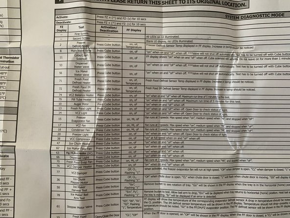

    • Your refrigerator has a diagnostic mode. This can be used to force states of components and verify the state of others.
    • On my unit I located a datasheet hidden under the hinge cover on the top of the unit. This contains a wiring schematic as also a table of the diagnostic functions. The font is small and hard to read, the fact this is hidden also suggests there are likely many revisions. All that is to say I recommend pulling your sheet to reference.
    • Useful video demonstrating function: https://youtu.be/B3p-LwYWGTo?si=fRRvgkj0...
    • For me I used function 56 to test the IM water valve ( verify supply line unfrozen) function 50 to test harvest motor
