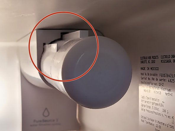

    2. Frigidaire Gallery Water Filter Replacement: step 2, image 1 of 2 Frigidaire Gallery Water Filter Replacement: step 2, image 2 of 2
      • Push back on the compartment to remove the filter.
      • The filter will then pop out.
      • Remove the used filter and discard it.

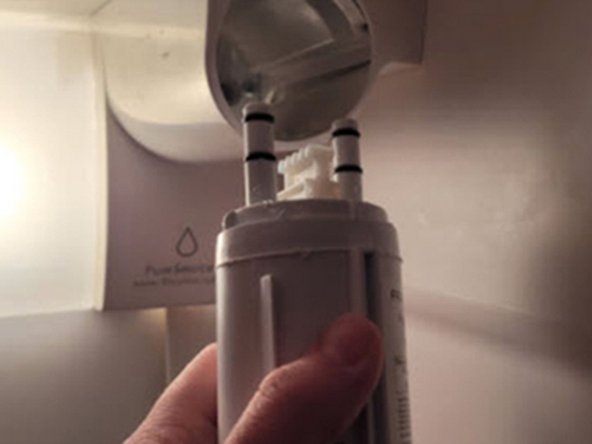

    3. Frigidaire Gallery Water Filter Replacement: step 3, image 1 of 3 Frigidaire Gallery Water Filter Replacement: step 3, image 2 of 3 Frigidaire Gallery Water Filter Replacement: step 3, image 3 of 3
      • Unwrap the replacement filter from its packaging.
      • Insert the replacement filter into the water filter housing.
      • You should hear an audible click when the filter is in place.
