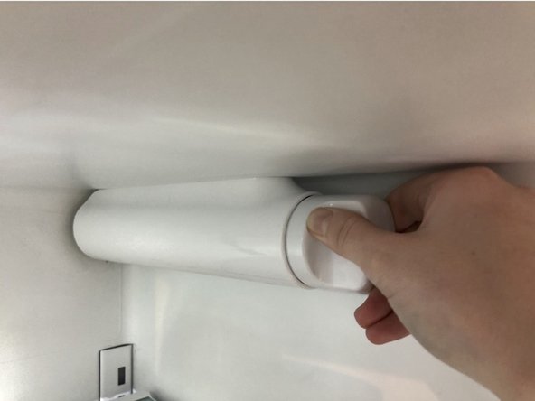

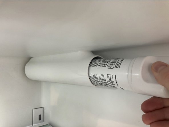

  4. Frigidaire FFHB2750TD6 Water Filter  Replacement: step 4, image 1 of 3 Frigidaire FFHB2750TD6 Water Filter  Replacement: step 4, image 2 of 3 Frigidaire FFHB2750TD6 Water Filter  Replacement: step 4, image 3 of 3
    • To remove the water filter turn it to the right until you feel it detach.
    • Then pull the filter straight out slowly from its slot.
    • Water may drip from the filter upon removal. Putting a towel underneath and removing products from that area will ensure an easy clean-up.

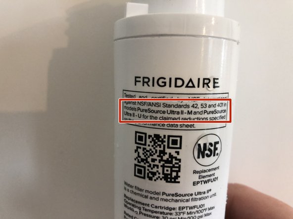

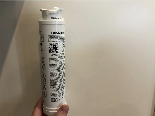

  5. Frigidaire FFHB2750TD6 Water Filter  Replacement: step 5, image 1 of 2 Frigidaire FFHB2750TD6 Water Filter  Replacement: step 5, image 2 of 2
    • Once the filter is removed, identify the model number on it.
    • The model number will ensure you buy the correct replacement at the store.

  6. Frigidaire FFHB2750TD6 Water Filter  Replacement: step 6, image 1 of 2 Frigidaire FFHB2750TD6 Water Filter  Replacement: step 6, image 2 of 2
    • Upon getting the new filter from the store install it into the fridge.
    • Insert the filter straight into its designated slot.
    • Twist the filter to the right until you feel and hear it click into place.
