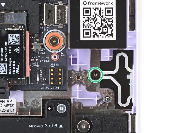

Prereq only guide to remove the power button.
    1. Framework Laptop 12 Power Button Removal, Remove the power button: step 1, image 1 of 1
      • Use your Framework Screwdriver to remove the 2.0 mm‑long T5 Torx screw securing the power button.
      Ask FixBot
    2. Framework Laptop 12 Power Button Removal: step 2, image 1 of 2 Framework Laptop 12 Power Button Removal: step 2, image 2 of 2
      • Lift and remove the power button.
      Ask FixBot
