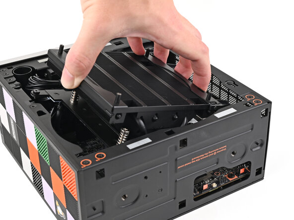

    1. Framework Desktop Heatsink Installation, Place the heatsink: step 1, image 1 of 2 Framework Desktop Heatsink Installation, Place the heatsink: step 1, image 2 of 2
      • Tilt the heatsink down towards the rear of the Desktop and place it into its slot on the Mainboard.
      • Only grab the heatsink by its left and right edges (the edges facing the back I/O ports and the Primary SSD). If you grab the other edges, you risk bending the heatsink fins.
