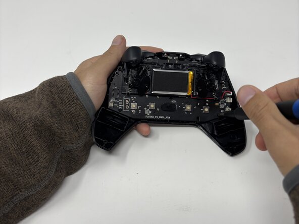

    2. Flydigi Vader 4 Pro Action Button Replacement: step 2, image 1 of 2 Flydigi Vader 4 Pro Action Button Replacement: step 2, image 2 of 2
      • Insert an opening pick into the seam between the rear and front case.
      • Pry around the perimeter of the controller.
      • Remove the rear case and set it to the side of the front case, with care not to strain the connected cable.

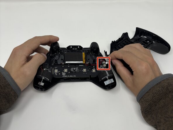

    3. Flydigi Vader 4 Pro Action Button Replacement: step 3, image 1 of 1
      • Disconnect the JST-PH connector from its motherboard socket.

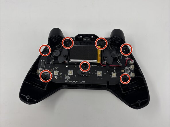

    1. Flydigi Vader 4 Pro Action Button Replacement, Mainboard: step 5, image 1 of 3 Flydigi Vader 4 Pro Action Button Replacement, Mainboard: step 5, image 2 of 3 Flydigi Vader 4 Pro Action Button Replacement, Mainboard: step 5, image 3 of 3
      • Remove the seven 10 mm screws securing the mainboard using a Phillips #0 screwdriver.
      Ask FixBot
    2. Flydigi Vader 4 Pro Action Button Replacement: step 6, image 1 of 3 Flydigi Vader 4 Pro Action Button Replacement: step 6, image 2 of 3 Flydigi Vader 4 Pro Action Button Replacement: step 6, image 3 of 3
      • Remove the mainboard.

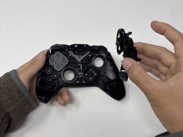

    2. Flydigi Vader 4 Pro Action Button Replacement: step 8, image 1 of 3 Flydigi Vader 4 Pro Action Button Replacement: step 8, image 2 of 3 Flydigi Vader 4 Pro Action Button Replacement: step 8, image 3 of 3
      • Remove the bracket.
      Ask FixBot
    3. Flydigi Vader 4 Pro Action Button Replacement: step 9, image 1 of 2 Flydigi Vader 4 Pro Action Button Replacement: step 9, image 2 of 2
      • Remove the rubber action button gasket.
      Ask FixBot
    4. Flydigi Vader 4 Pro Action Button Replacement: step 10, image 1 of 2 Flydigi Vader 4 Pro Action Button Replacement: step 10, image 2 of 2
      • Replace the action buttons.
