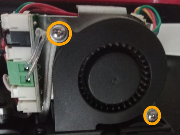

    4. Flashforge Finder 2 Fan Cleaning or Replacement, Unscrew the fan: step 4, image 1 of 2 Flashforge Finder 2 Fan Cleaning or Replacement, Unscrew the fan: step 4, image 2 of 2
      • Remove the two Phillips screw holding the fan

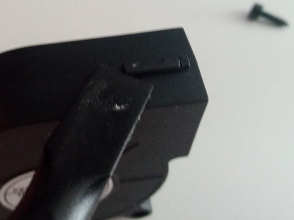

    5. Flashforge Finder 2 Fan Cleaning or Replacement, (Optional) Disassemble the fan: step 5, image 1 of 2 Flashforge Finder 2 Fan Cleaning or Replacement, (Optional) Disassemble the fan: step 5, image 2 of 2
      • The fan can now be removed from the extruder. If you need to replace it, just follow the steps in reverse order with the new fan
      • If you are cleaning the fan, release the three clips holding it together with a spudger
