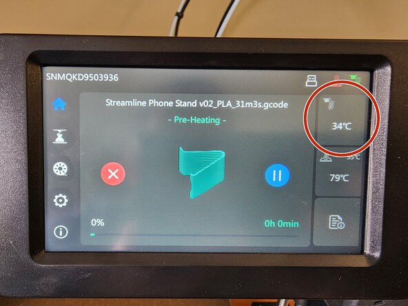

Adventurer 5M Cold Pull Procedure to help clean the nozzle without removal of the nozzle
    1. Flashforge 5M Cold Pull Maintenance, Heat up the nozzle: step 1, image 1 of 1
      • Start by cutting and removing any current filament that is loaded inside the nozzle. Then heat the nozzle by pressing the nozzle temperature icon, a popup should appear asking you how hot you would like the nozzle. Heat up to 230 degrees or higher.
      • The heat bed does not need to be heat up.
