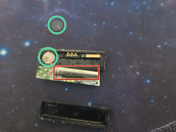

      • This is a pretty standard electronic glue removal task. You can find much better guides of how to do this on this site, Youtube, etc. if you have never done it before.
      • Use a razorblade or prying tool to cut through the glue on the long edges of the fitbit. As long as you see white stuff coming out, keep cutting as there was quite a bit of glue. I did not heat the glue but it may have helped as I have done that in the past.
      • Once the glue was mostly gone, I used a sharp flathead screwdriver to do the initial prying and then a pick to pull it apart completely. I chewed the plastic a little with the metal screwdriver but its not that bad.
      • I initially thought the accelerometer was the battery (again, not a professional) so I peeled off a little black insulator disc that was stuck to it. Don't do this. I don't think it is a big deal but I will have to glue it back.
      • The thing with the red rectangle is the battery we need to replace.
