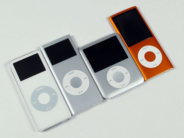

The iPod Nano 4G!
Many of the new Nano's features are software-based, but there are still a lot of exciting changes inside.
We're excited to see exactly how they integrated the curved glass into the case.
Standard contents included. You have to fork over $80 to get the fancy new headphones with the volume control.

Unfortunately, just like every other Nano, this iPod wasn't designed with serviceability in mind. Sliding the insides out of the casing proved quite difficult.
slide the insides out until the very lowest connector is visible, about 1/4 of an inch. Be sure to undo this connector before sliding the inides out as seen in the picture.
