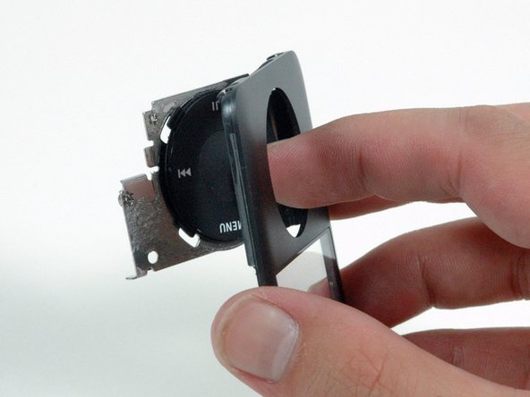

  • Now we use a spudger to pry up the display, which is held along the case's edge by an adhesive strip.
  • The first generation Nano's display was attached in exactly the same way. If you're not careful when prying it up, you may crack it.
  • We're noticing a strong trend as we take apart this iPod: adhesive.
  • The click wheel is held in place by nothing but a very strong adhesive, which is going to make replacing it difficult. You'll have to get it to stay in place as well as Apple has (i.e. very well).

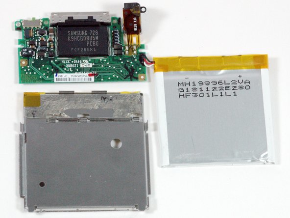

  • Here the battery is out of its metal housing, which is attached to the logic board by, that's right, adhesive.
  • The battery is attached to the logic board by three through-hole solder points, as in the second generation Nano (sorry, no easy replacements).

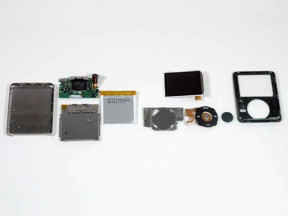

  • And here's everything together again, but apart.

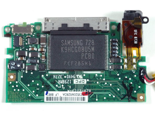

  • A close-up of the logic board's top, which sports an eight gigabyte Samsung flash memory chip and headphone jack.
  • The headphone jack is soldered to the logic board, as in the first generation Nano, but not in the second.

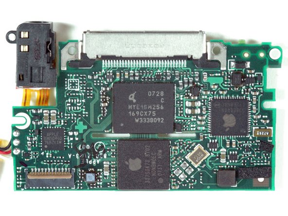

  • A close-up of the logic board's bottom.
The top middle chip (below the dock connector is 256 megs of sdram
Lucas Hoekstra (Lucas9810) - Reply

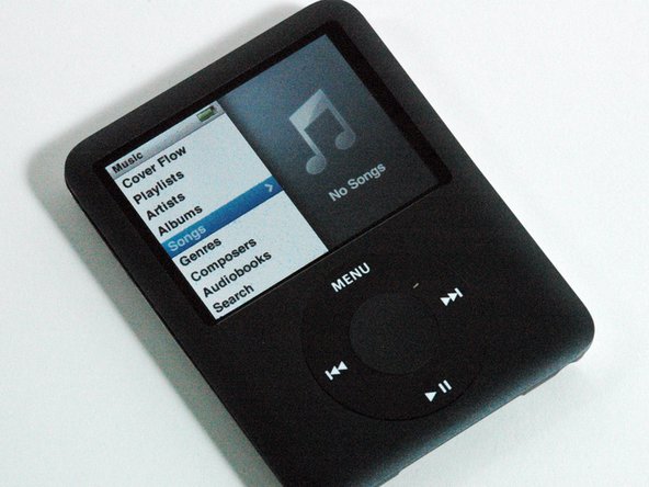

  • And it still works! Now, having satisfied our curiosity, we can put some music on it.
