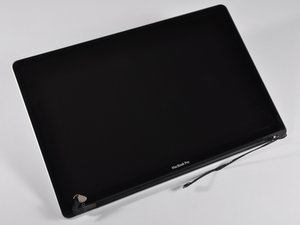

    3. MacBook Pro 17" Unibody Teardown: step 3, image 1 of 1
      • Physical dimensions: 0.98 x 15.47 x 10.51 inches and 6.6 pounds.
      • For comparison, the 15" model measures 0.95 x 14.35 x 9.82 inches and 5.5 pounds.
      • There's something almost spiritual about the blackness of that screen. Much to our dismay, it is not full of stars and David Bowman is nowhere to be found.

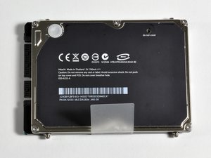

      • Tidbits from Apple System profiler:
      • 12,820 mAh capacity. Yes, that's 12.8 AMP HOURS. Let's hope it actually lasts the 1,000 discharge cycles that Apple claims.
      • Our battery already had 3 cycles on it! I wonder if the famous factory girl tested ours.
      • A 2 GB DDR3 1067 MHz RAM chip is installed in each slot, as expected.
      • The hard drive is a 320 GB Hitachi HTS543232L95A02 SATA drive using the NVIDIA MCP79 AHCI controller.

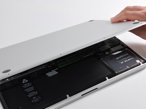

    6. MacBook Pro 17" Unibody Teardown: step 6, image 1 of 2 MacBook Pro 17" Unibody Teardown: step 6, image 2 of 2
      • We removed the screws, and we're rotating off the lower case now.
      • The second picture reveals the beautiful internals. Look how huge that battery is!
      • The serial number is now engraved on the lower case, not on the Unibody upper case as they do on the 15" Pro and 13" Unibody.

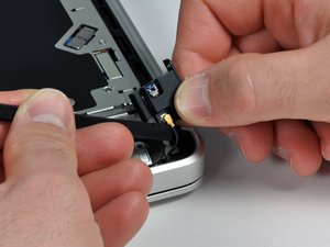

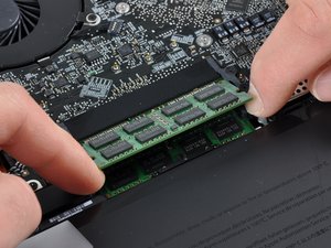

    7. MacBook Pro 17" Unibody Teardown: step 7, image 1 of 2 MacBook Pro 17" Unibody Teardown: step 7, image 2 of 2
      • Disconnecting the battery connector.
      • It's probably a good idea to disconnect this cable before continuing to disassemble the machine.
      • The second photo is removing a 2 GB DDR3 RAM chip.

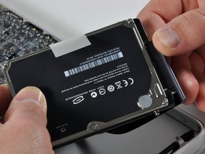

    8. MacBook Pro 17" Unibody Teardown: step 8, image 1 of 3 MacBook Pro 17" Unibody Teardown: step 8, image 2 of 3 MacBook Pro 17" Unibody Teardown: step 8, image 3 of 3
      • To remove the hard drive, unscrew the two small Phillips screws holding the black plastic hard drive bracket to the chassis. Pull up on the white plastic tab and lift the hard drive out of the case, being careful not to strain the SATA cable.
      • Carefully disconnect the Serial ATA cable.

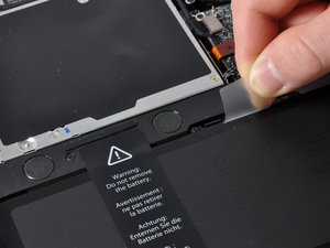

    9. MacBook Pro 17" Unibody Teardown: step 9, image 1 of 2 MacBook Pro 17" Unibody Teardown: step 9, image 2 of 2
      • Ignoring all manufacturer warnings, we are removing the non-removable battery. Hold your breath!
      • There are three tri-wing screws holding the battery to the Unibody case.
      Ask FixBot

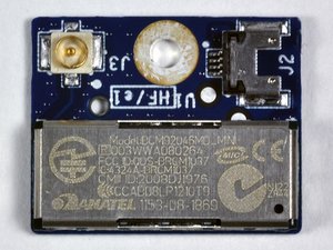

    11. MacBook Pro 17" Unibody Teardown: step 11, image 1 of 3 MacBook Pro 17" Unibody Teardown: step 11, image 2 of 3 MacBook Pro 17" Unibody Teardown: step 11, image 3 of 3
      • The Bluetooth board is right behind the optical drive, next to the hinge.
      • It's very nice that Apple moved this out of the display assembly (where it is located in the MacBook Unibody and 15" MacBook Pro Unibody). No longer does a Unibody owner need to replace their entire display assembly ($$$) when their Bluetooth goes out.
      • It has an Anatel logo on it: BCM93046MD MINI 003WWA080264 FCC iD:QDS-BRCM1037.
      • Like the other Unibody machines, the Airport card is in the display assembly clutch cover.

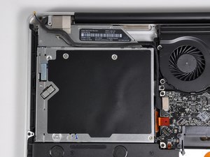

    12. MacBook Pro 17" Unibody Teardown: step 12, image 1 of 3 MacBook Pro 17" Unibody Teardown: step 12, image 2 of 3 MacBook Pro 17" Unibody Teardown: step 12, image 3 of 3
      • The 8x slot-loading SuperDrive (DVD±R DL/DVD±RW/CD-RW).
      • The internal design of this machine is pretty consistent with the 15" MacBook Pro. We'll be posting some part comparison shots later to show relative sizing.

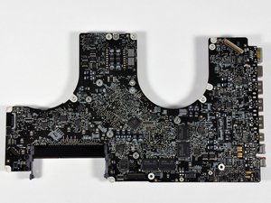

    13. MacBook Pro 17" Unibody Teardown: step 13, image 1 of 1
      • The bottom of the logic board.
      • The component density is amazing.
      • There are four Samsung K4J10324QD-HC12 chips, likely video RAM for the NVidia 9600 chipset.

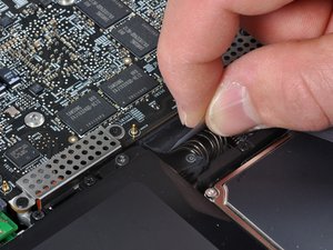

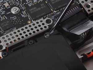

    15. MacBook Pro 17" Unibody Teardown: step 15, image 1 of 1
      • Removing the Phillips screws securing the perforated metal covers to the Unibody. These covers seem to protect the ribbon cable connections for the trackpad, keyboard, express card, and the serial ATA hard drive. Apple hasn't used metal shields like this before.

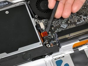

    16. MacBook Pro 17" Unibody Teardown: step 16, image 1 of 1
      • Bottom of logic board with fans removed.
      • Disconnecting a number of connector cables:
      • LVDS, keyboard backlight, iSight, speaker, IR/sleep sensor, trackpad, keyboard, Express card, hard drive, and battery indicator light

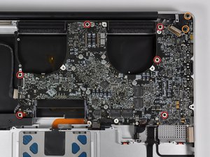

    17. MacBook Pro 17" Unibody Teardown: step 17, image 1 of 2 MacBook Pro 17" Unibody Teardown: step 17, image 2 of 2
      • The logic board with all connectors removed.
      • Remove the following eight screws:
      • Six 3 mm Phillips from the logic board
      • Two 7.2 mm Phillips from the MagSafe board
      • Second image: removing logic board.

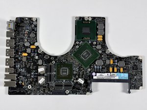

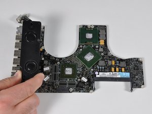

    18. MacBook Pro 17" Unibody Teardown: step 18, image 1 of 1
      • Top of logic board.
      • The speakers are mounted on the left next to the ports.
      • The heat sink covers the two NVidia chipsets and the processor.
      • This machine has 512 MB video memory for the NVidia 9600M. The 9400M chipset shares 256 MB of system memory. You have to log out to switch between graphics chipsets.

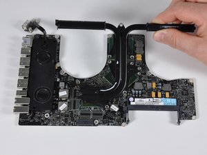

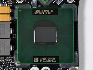

    19. MacBook Pro 17" Unibody Teardown: step 19, image 1 of 3 MacBook Pro 17" Unibody Teardown: step 19, image 2 of 3 MacBook Pro 17" Unibody Teardown: step 19, image 3 of 3
      • Removing the black heat sink and heat conduit.
      • Second image: The processor and two NVidia chipsets revealed!
      • Intel processor: Intel 5831C024 SLGEL AV80576T9550 2.66 / 6M / 1066
      • No surprises there: 2.66 GHz, 6 MB L2 Cache, 1066 MHz bus, just as advertised.

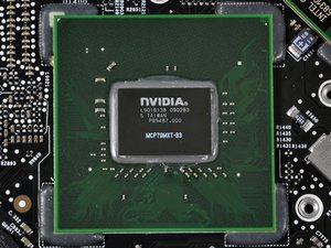

    20. MacBook Pro 17" Unibody Teardown: step 20, image 1 of 3 MacBook Pro 17" Unibody Teardown: step 20, image 2 of 3 MacBook Pro 17" Unibody Teardown: step 20, image 3 of 3
      • We removed the heat sink thermal compound so you can see the die markings.
      • Left image: Intel processor. No die markings!
      • Middle image: NVidia L901B138 0902B3 PB9487.000 MCP79MXT-B3
      • Right Image: NVidia 50N3BF 0850C1 NK6791.S1W NB9P-GS-W2-C1

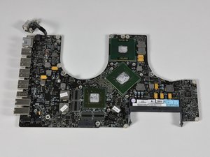

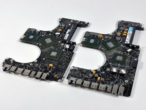

    21. MacBook Pro 17" Unibody Teardown: step 21, image 1 of 3 MacBook Pro 17" Unibody Teardown: step 21, image 2 of 3 MacBook Pro 17" Unibody Teardown: step 21, image 3 of 3
      • Left: 15" Unibody logic board
      • Right: 17" Unibody logic board
      • What's different? The biggest difference to you is the additional USB port. Oh, and $800.
      • The low-end 15" board that we took apart in October only has 256 MB video memory (Samsung RAM soldered onto the board). The high-end 15" and this 17" have 512 MB video RAM.
      Ask FixBot

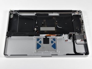

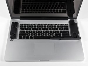

    22. MacBook Pro 17" Unibody Teardown: step 22, image 1 of 2 MacBook Pro 17" Unibody Teardown: step 22, image 2 of 2
      • The most famous upper case in the world, Apple's 'brick' CNC-manufactured Unibody case.
      • The second shot shows the speaker placement. We took the speakers out and put them on top of the case in the same position and orientation that they are internally.

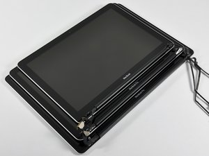

    23. MacBook Pro 17" Unibody Teardown: step 23, image 1 of 3 MacBook Pro 17" Unibody Teardown: step 23, image 2 of 3 MacBook Pro 17" Unibody Teardown: step 23, image 3 of 3
      • We removed the display assembly.
      • Here we have the 13", 15", and 17" MacBook displays stacked together.

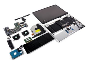

    24. MacBook Pro 17" Unibody Teardown: step 24, image 1 of 1
      • Clockwise from top left: Logic board, heat sink, display, unibody upper case, battery, hard drive, speakers. Fans, RAM, and optical drive are in the center.
      • There you have it! Be sure to check back often for more first looks, guides, and quality parts!
