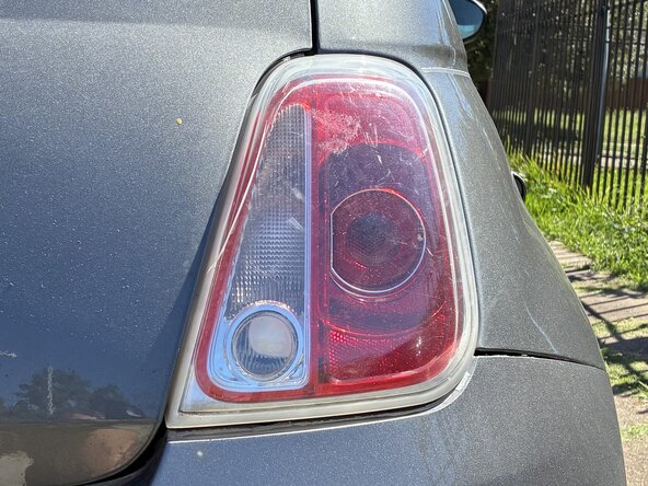

Fiat Stop Light Replacement

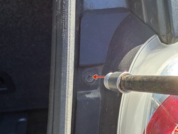

      • Remove the two 10 mm bolts to the side of the taillight.

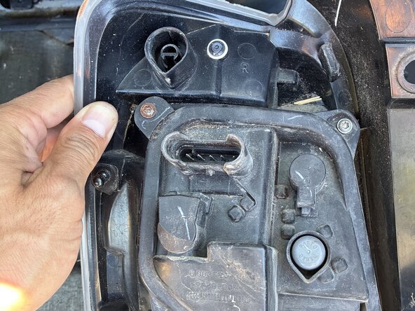

      • Remove the burnt out bulb by pulling it out from the panel.

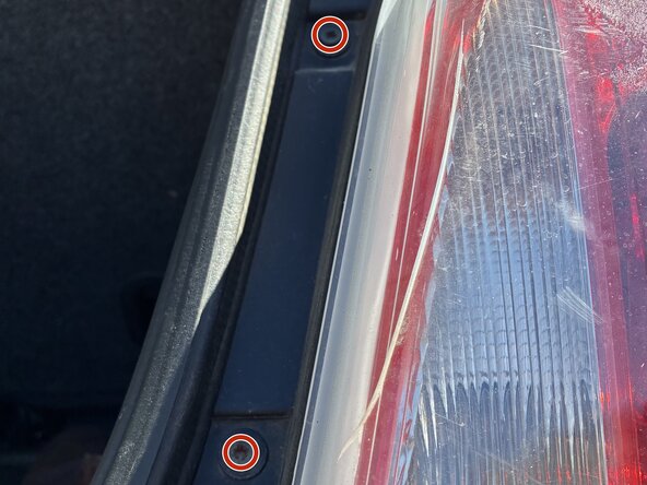

      • Open the hatch door and locate the two screws under the hatch lip. Then, use the 10mm socket and unscrew both top and bottom screws.

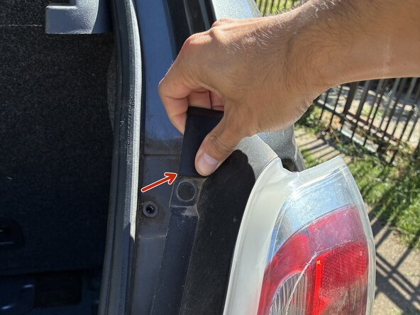

      • Remove the screws by hand. Then, remove plastic casing from the body.

      • Remove the casing carefully. There is a wire harness that needs to be disconnected. See red line under the wire harness.
      • Carefully insert a flat head screw driver into the lock lip while simultaneously pulling the harness out of its socket.
