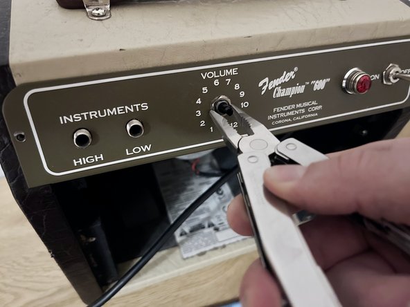

    • Now it's time to remove the nuts on the input jacks and our broken volume pot - I used pliers to do that, but it is advisable to use a small adjustable wrench in order to avoid any unwanted scratches.

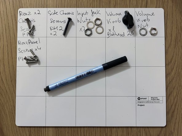

    • Next let's remove the volume knob - you'll need a flat 2.5 bit for that. Carefully insert the bit into the hole on the rear side of the knob to undo a tiny screw inside of it.
    • That's it - chassis is free 👍.
    • Hint: use a plastic tray or a magnetic mat to safely store all of those screws and nuts. You can even write where all those parts come from.

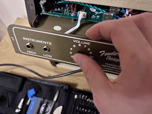

    • Slightly lift it up and pull towards you with just a hand to access the internals.
    • That's it - the amp's chassis is right in front of you.

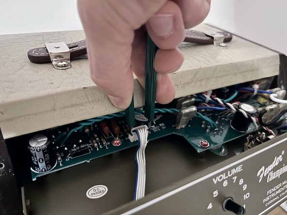

    • Disconnect the panel that holds the input jacks and our volume pot. For this you may either use your fingers or an IC Extractor/Connector Puller.
    • Then lightly push one of the input jacks inside of the chassis to remove the panel.

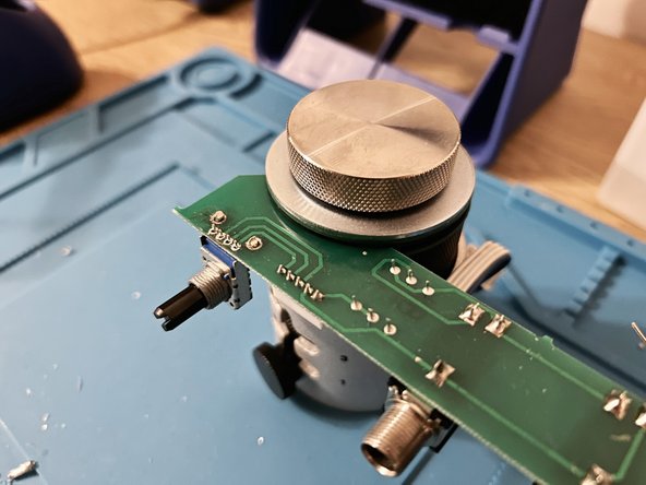

    • Now let's replace a broken volume pot. For this we are obviously going to need a soldering iron, a flush cutter and a desoldering pump.
    • Hint - I used flush cutters to cut a broken pot off from the PCB and then used a desoldering pump to clean the mounting holes in order to get them ready for a new pot.
    • Also a good PCB holder may come in handy as you may see in my example.
