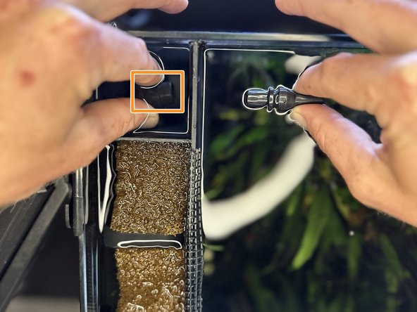

    4. Fast Fix Fluval Spec V Impeller Replacement: step 4, image 1 of 2 Fast Fix Fluval Spec V Impeller Replacement: step 4, image 2 of 2
      • Caution: To protect Neocaridina shrimps, nano fish, and other small aquatic creatures in your aquarium, an extra precautionary step is necessary due to the potential danger posed by the outlet leading into the filtration compartment, which could cause them to get stuck behind the divider.

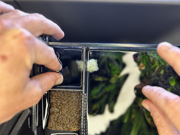

      • Cover Outlet (Optional): Carefully insert a suitable filter medium into the outlet.
      • This could be a piece of sponge, mesh, or any other aquarium-safe material that allows water flow while preventing the shrimps or fish from entering the filtration compartment. Be sure to securely place the filter medium so that it doesn't shift or come loose, potentially leaving the outlet unprotected.

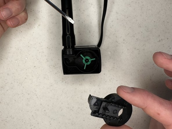

    6. Fast Fix Fluval Spec V Impeller Replacement: step 6, image 1 of 2 Fast Fix Fluval Spec V Impeller Replacement: step 6, image 2 of 2
      • Insert Pry Tool: Take your small pry tool and carefully insert it anywhere under the edge of the pump cover.
      • Pry Off Cover: Gently pry it off by twisting the tool.
      • Twisting the pry tool will give you a smoother, more controlled prying action and minimize the risk of the cover suddenly popping off or flying away.
      Ask FixBot
    7. Fast Fix Fluval Spec V Impeller Replacement: step 7, image 1 of 2 Fast Fix Fluval Spec V Impeller Replacement: step 7, image 2 of 2
      • Insert Pry Tool: Carefully insert your pry tool anywhere under the edge of this cover.
      • Pry Off Cover: Gently pry it off.
      • Be sure to handle with care to prevent any damage to the impeller assembly underneath.

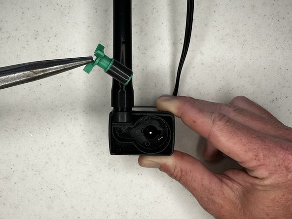

    8. Fast Fix Fluval Spec V Impeller Replacement: step 8, image 1 of 2 Fast Fix Fluval Spec V Impeller Replacement: step 8, image 2 of 2
      • Grasp Impeller: Get a firm but gentle grip on the impeller.
      • The impeller is inset, making it difficult to grasp by hand. In this case, a pair of needle-nose pliers will come in handy.
      • Pull Out Impeller: Slowly and carefully pull it straight out.
      • Do not to twist or yank the impeller to prevent damage to it or the pump assembly.
      Ask FixBot
    9. Fast Fix Fluval Spec V Impeller Replacement: step 9, image 1 of 1
      • Install New Impeller: Take your new impeller and carefully align the slot with the pin in the impeller housing. Gently slide the new impeller on to the pin, ensuring that it's oriented correctly.
      • The impeller is magnetic, so it will naturally adhere to the motor assembly and does not require any additional securing. Once the impeller is in place, it should spin freely when nudged. This will confirm that it has been installed correctly.
