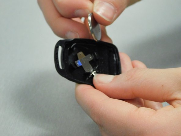

      • Use a small and thin object, like a penny or other coin, to pry open the FOB. It will separate into two pieces.

      • Remove both batteries from the FOB by releasing them from the prongs.

      • Insert the new CR2016 batteries with the positive side facing down, and make sure the batteries are secure under the prongs.
