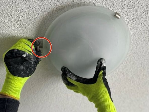

Fast Fix Ceiling Clip Mount Light Bulb Replacement
    1. Fast Fix Ceiling Clip Mount Light Bulb Replacement, Ceiling Clip Mount Light Bulb: step 1, image 1 of 2 Fast Fix Ceiling Clip Mount Light Bulb Replacement, Ceiling Clip Mount Light Bulb: step 1, image 2 of 2
      • Turn off the electrical circuit breaker and the light switch.
      Ask FixBot
    2. Fast Fix Ceiling Clip Mount Light Bulb Replacement: step 2, image 1 of 2 Fast Fix Ceiling Clip Mount Light Bulb Replacement: step 2, image 2 of 2
      • Carefully pull the clip and remove the mount.
      Ask FixBot
    3. Fast Fix Ceiling Clip Mount Light Bulb Replacement: step 3, image 1 of 1
      • Unscrew the light bulb’s electrical foot contact from the socket.
      Ask FixBot
    4. Fast Fix Ceiling Clip Mount Light Bulb Replacement: step 4, image 1 of 2 Fast Fix Ceiling Clip Mount Light Bulb Replacement: step 4, image 2 of 2
      • Carefully screw the new light bulb into the socket.
      Ask FixBot
    5. Fast Fix Ceiling Clip Mount Light Bulb Replacement: step 5, image 1 of 1
      • Turn the light switch and the circuit breaker back on to check if the light bulb(s) are working before putting the mount cover back on.
      Ask FixBot
    6. Fast Fix Ceiling Clip Mount Light Bulb Replacement: step 6, image 1 of 2 Fast Fix Ceiling Clip Mount Light Bulb Replacement: step 6, image 2 of 2
      • Once the light bulb(s) are working, place one hand under the mount. Pull the clip back and let it settle in place.
      Ask FixBot
If the lightbulb does not work after step 7, then you need to get a new lightbulb and repeat step 5-7. If it still does not work then your socket might need a replacement.
