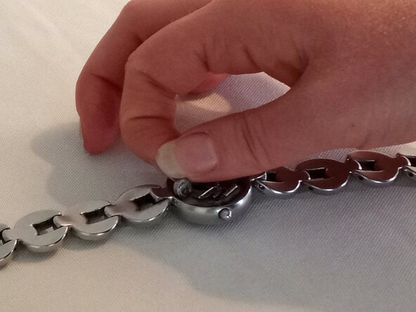

      • Place the tip of a watch prying knife under the tab and push it in until it stops. Lift the knife in an upwards motion followed by a downwards motion. You should hear a "click."
      • Repeat if needed until the back pops off.

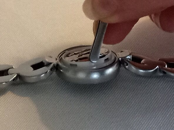

      • Using tweezers, grip the edge of the white plastic ring and lift it up and out of the watch.

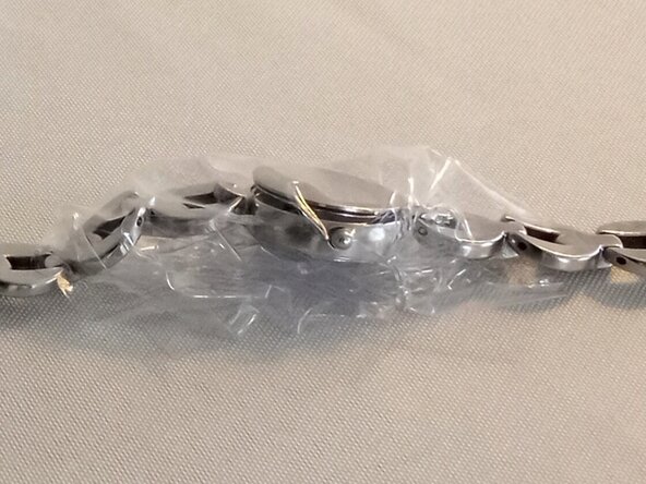

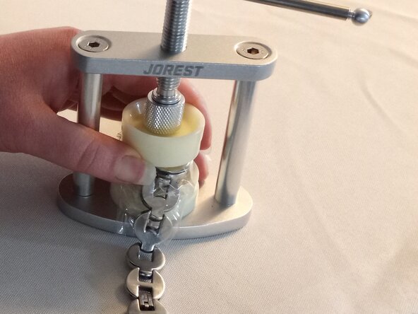

      • Locate the notch under the tab on the watch back. Line up the notch so that it sits over the knob that operates the watch hands.
      • Place a square of plastic film under the watch front and another square over the back.
      • You can lay them flat as shown or wrap the watch in a single square.

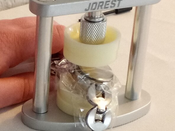

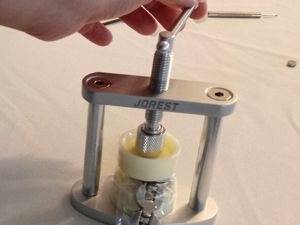

      • Lay the watch in the watch press die with the back facing up.
      • Turn the lever in a counter-clockwise motion.
      • When the top die is has almost reached the watch, hold it with your left hand to keep it in place. Continue to turn the lever until the top die has gone as far as it can go.

      • Turn the lever in a clockwise motion until the top die has reached it's original height.
